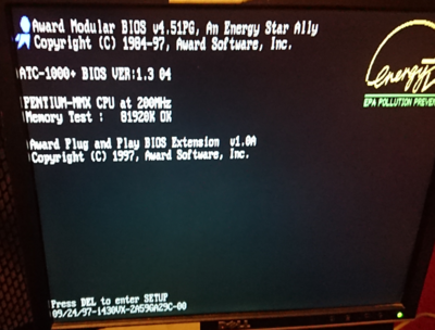

I got my hands on penitum 200mhz mmx cpu and something is a little weird, my machine would not post with the correct jumpers (according to the manual)
However it does post and say it penitum mmx 200 with one jumper on single voltage (not dual voltage) and another jumper (again according to the manual) is on p54c std not p55c but it the only way it will post
Will I be OK leaving it like this

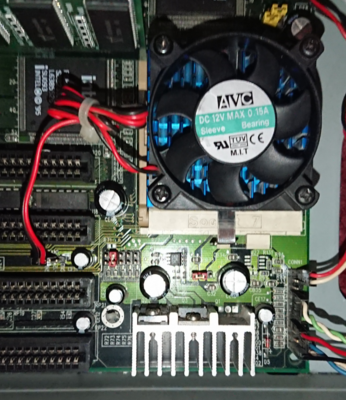

Reply 6 of 32, by dionb
Some very early So7 boards were made with optional support for P55C, with place for the required VRM, and jumpers to go with it, but without the VRM itself. Does it look like there is VRM circuitry near the CPU socket linked to JP6? If not, it might explain why it doesn't work...
Reply 7 of 32, by Robhalfordfan
I don't see a vrm near jp 6, only a capacitor and a metal heatsink near bottom of mobo (well what looks like a heatsink)
Reply 8 of 32, by Robhalfordfan
Here is a pic of the section where there is heatsink
Reply 9 of 32, by Deksor
There are two transistors screwed in that heatsink which are there to regulate the CPU voltage. But as you can see, on the right there is a spot for a third one. I'm not sure if it's needed, but the circuit has been made for three transistors.
Reply 10 of 32, by Robhalfordfan
I am guessing even tho there is jumper for dual voltage, is no circuit for it, hence when the jumpers are set right according to manual for this cpu doesn't boot or post
Is a way to get the part for vrm to screw and solder into the third space on the heatsink or will it easier to get another socket 7 AT motherboard that has the circuit for dual voltage
Here is a pic of post screen with jumpers set for single voltage and p54c set (which is what my p133 was at), only jumpers that needed to be changed was the multiplier setting

Reply 11 of 32, by Deksor
I guess you could ask somebody that has this board what's the reference of the missing transistor ?
Maybe this ebay seller would help you : https://www.ebay.com/itm/A-Trend-ATC-1000-V-2 … m-/172146172367
If you have ok soldering skills, this should be easier to do than finding another socket 7 mobo for cheap.

Reply 15 of 32, by Deksor
Now that I look closer, that third transistor might not be the only missing component : there's a missing IC with "U27" labeled on the PCB. According to the ebay seller's photos, it seems to be the same as U26 IC.
Soldering SMD is more tough than a normal component, but if you feel you can do it, there are tutorials to teach you how to do that with a normal soldering iron
Reply 16 of 32, by Robhalfordfan
OK prob easier to find another AT motherboard or same one with appropriate transistors already there (just need to see if sellers are willing to sell the mobo on their own)
Reply 17 of 32, by Robhalfordfan
i have found the same mobo as the current one in this build but it has the transistor and ic chip for dual voltage already there, so fingers crossed, the issues is solved
Reply 18 of 32, by Robhalfordfan
got the mobo (with appropriate parts already there) and over a month later working no problem
