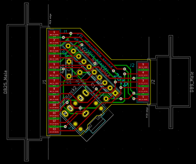

Hi everyone!
The FTL Sound Adapter is fully documented in the Dungeon Master Encyclopaedia. (See http://dmweb.free.fr/?q=node/1514, more photos at http://dmweb.free.fr/?q=node/622.)
And the Covox Speech Thing has been fully reverse engineered, as well. (Over in the CVX thread at CVX4 : high quality covox adapter – awesome job, folks!)
How much interest is there in somewhat more accurate replicas of these devices?
So far, I've created the following PCB layouts, one for an FTL Sound Adapter replica:
The attachment FTL_Sound_Adapter_replica_layout.png is no longer available

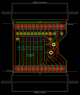

And one for a Speech Thing:
The attachment Speech_Thing_replica_layout.png is no longer available
They would largely use the same components. The filter capacitor on the Speech Thing would be left unpopulated.
Furthermore, I've been able to identify all visible components on Cloudschatze's photo of the SoundJr (also in the CVX thread).
There's really nothing fancy on there, only a few resistors, diodes, PNP transistors and a big tantalum capacitor.
So with a bit of additional information that device is within reach, as well.
Any suggestions? What do you think?

I'm sure if you did a PCB group buy or something, some of the guys with older laptops would go for it. If you don't have any interest in being a distributor of products with meager margins, publish it to OSH Park's projects page and let people order them individually. Anyone with a soldering iron can build one.

My intention is to get PCBs and components for about 10 pieces each, just to prove that the designs are error-free and because that is the smallest somewhat economic batch size.
I'd then publish the design documents, package some DIY kits to recuperate the cost and leave it at that.
For the FTL Sound Adapter and the Covox Speech Thing that is easy because other people have already done all the hard work.

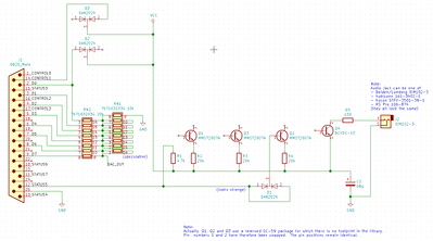

The SoundJr reverse engineering effort is still ongoing. Right now, this is all I have:
The attachment SoundJr_schematic_front_only.png is no longer available
It is entirely based on this information (text and picture):
Cloudschatze wrote:
Wayne Foletta (Silicon Shack / SiliconSoft) produced a neat little LPT DAC known as the "SoundJr" back in the late 1980s. It's n […]
Wayne Foletta (Silicon Shack / SiliconSoft) produced a neat little LPT DAC known as the "SoundJr" back in the late 1980s. It's not as advanced as some of the designs being discussed, but has a few interesting features. Instead of discrete resistors, this device employs a pairing of either 767163103 and 767163203, or 8A103 and 8A203 resistor array ICs. In addition, the SoundJr features software-controllable, 8-step volume attenuation. These (or similar) elements might be worth considering as part of a new design.
I have an extra unit, if there's any interest in a reverse-engineering effort. Otherwise, there's a passthrough version of the SoundJr on eBay that could be looked at, and isn't too terribly priced. The listing even includes some oddly nice photos of its PCB.
Unfortunately, eBay does not keep product photos forever. Those "oddly nice photos of its PCB" would have been helpful.
I found another piece of information on an ancient Geocities page:
The SoundJr use the standard printer port data pins (#2-9) for digital audio data and the control pins (#1, 14, 16, 17) for volume control. All these output pins are also used to supply power to directly to the amplifier and volume control circuits. The output is a standard 1/8" stereo mini-jack with the same signal (mono) on each channel.
If that is true, the selection of possible audio jacks can be narrowed down to just the stereo versions.

Reply 6 of 93, by Benedikt
The most interesting feature is its ability to drive headphones without sacrificing quality combined with software-controlled volume.
Also, I'd say that the 3mA it claims to consume, drawn from several pins combined, really aren't a lot.

I'm still not convinced that there's an amplifier IC in there. It wouldn't surprise me if that slightly bigger PNP transistor in the SoundJr is the amplifier.
Also, please note that it draws power from several pins combined.
