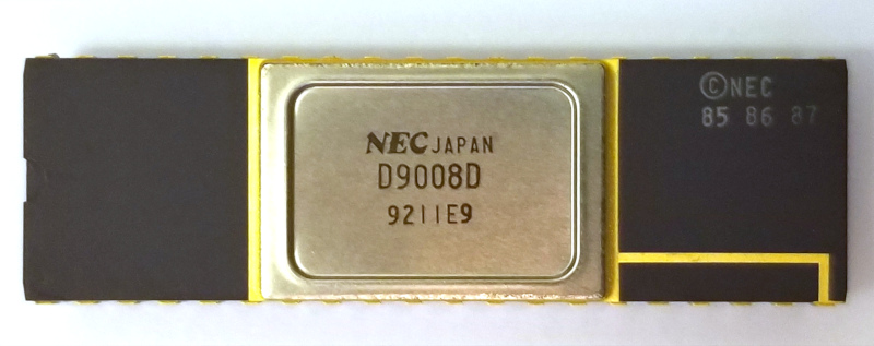

Those NEC x87 FPUs are CMOS. So they *might* overclock okay.
But, according to CPUShack they are only rated at 8MHz. I'm not sure how that was determined though, since I wasn't able to decipher the production code.
Even if you can only get it up to 10MHz, it still provides one advantage over standard 8087s...387 instruction set.

NEC D9008D FPU arrived today.
Unfortunately it does not get recognized by the beast XT machine.
Can be a BIOS problem. Can be something on signal level.
Regardless - that's the end of the Intel vs NEC 8087 story ... for now at least.
At some point later will try the chip in another XT but appetite is already low because i intention was to further boost that particular rig.
retro bits and bytes

Which CPU was installed when you tested? Was it a V20 or V30?
Did you try power cycling after first booting up?
Reply 1137 of 2154, by pshipkov
I don't have V20.
Only Intel 8086 and NEC V30 HL.
Tried hard to make it work - stripped the rig down to the bone with no extension cards, minimum RAM, etc.
When D9008D is in the socket - no lights, only the Tandy mobo produces this specific buzzing sound when something is off with the system.
Did you ever manage to run D9008D FPU ?
Reply 1138 of 2154, by Anonymous Coward
No. I have one at AVICC. I normally go visit my parents every 2 years (and pick up my packages), but it's already been almost 4.5 years since my last visit due to the pandemic.
I gave up on international shipping to China, because it's a pain in the arse to receive packages. I have to spend an entire day travelling to the provincial capital to pay the tax. Sometimes my packages disappear for many months, and sometimes they just get returned to sender.
