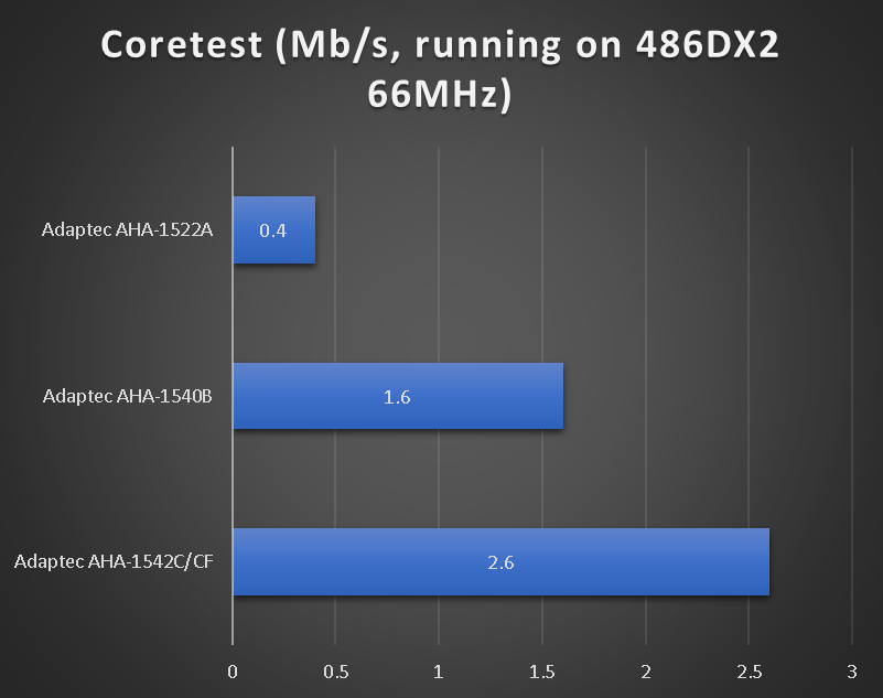

Why is the 1520B 80% faster than the 1542? I'm considering pulling the 1542 out of my AMI Mark V Baby Screamer with SXL2-66 and putting a 1522B in there. The 1542 is supposed to be the better because of DMA.
I then tried several PCI SCSI cards on the UUD, the 2940U2W, 2940W, 2940UW, and they all scored about 8700 KB/s.
Reply 563 of 2521, by pshipkov
Looked at some of the Adaptec ISA SCSI controllers before. For reference.
Coretest is in agreement with SpeedSys on read speed, so the numbers are relevant to what you observe over there.
C was much faster than B - this i remember clearly.
Surprised that you are seeing B faster than C.

Reply 564 of 2521, by feipoa
I don't see the 1520B or 1522B on that chart. Is the 1522A the same as the 1522B?
Reply 565 of 2521, by maxtherabbit
Don't quote me but I think the 152x series all use the same ASIC
Reply 566 of 2521, by pshipkov
Don't have B versions here, sorry.
No idea about the silicon, but the 15xx versions differ in perf for sure.
retro bits and bytes | DOS media library

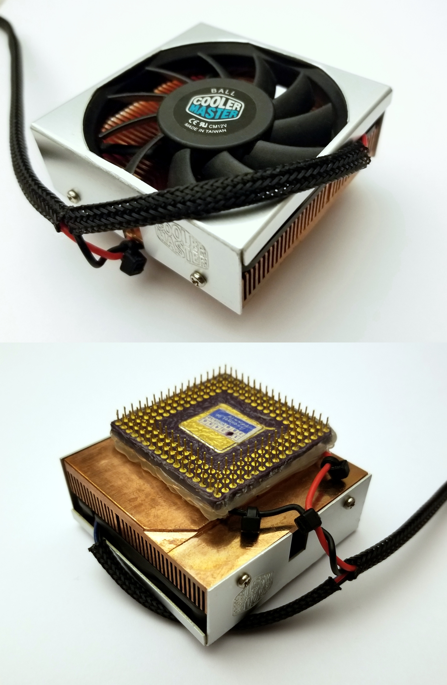

AMD X3-133ADW @ 3.45V + Peltier active cooling

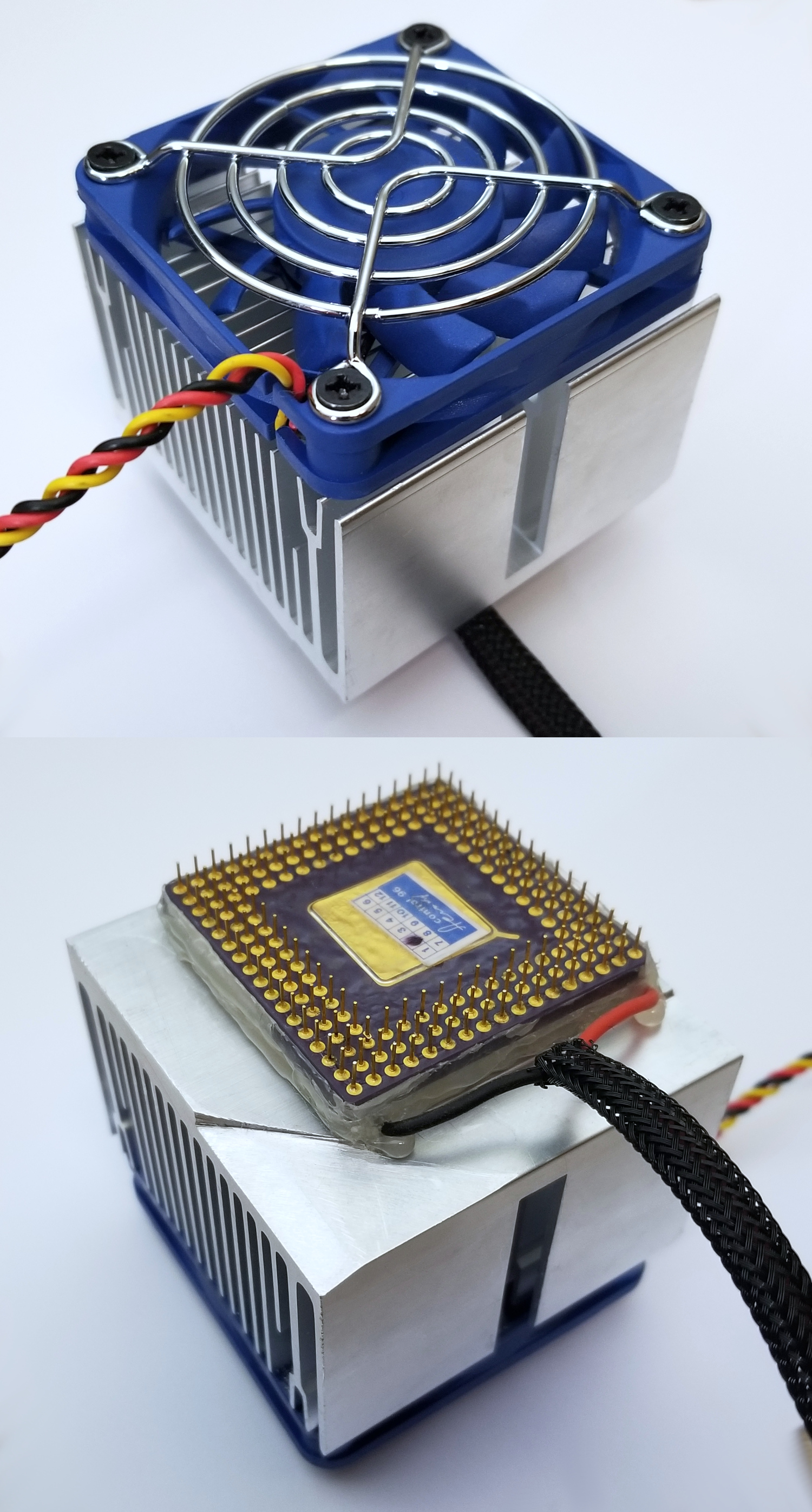

This particular CPU can do 180MHz in room temperatures pretty well, but is not fully stable.
The standard heatsink+fan is not enough, so Peltier thermal pump is inserted between processor/heatsink to normalize temperature range within 18-23C.
The lower the temperature the better, but if below ~18-20C - water condensation starts to build up. So, this enforces the lower boundary.
Fan size/speed, heatsink size/shape/material need to be balanced pretty well to ensure the right amount of heat is drained from the processor.
I mentioned this before but 2-3 out of 10 ADW/ADZ CPUs usually have healthy enough dies and can handle 180/200MHz.
Some require 4V at 180, some are ok with standard voltage.
All require 4V, or more for 200MHz.
So, overclocking past the 160MHz is actually easy. But doing it for a stable system is not trivial, as you can see below.
Initial design worked well on the open air test bench. Maintained the required 18-22C. Initial tests went well. Details here
Completed design. Used a plastic piece that wraps the CPU. Its "teeth" hold the heatsink. Zip-ties add just enough pressure for the contraption to be very sturdy, yet easy to disassemble.
Unfortunately it failed when inside closed PC case. Other components increased the ambient temperature enough for the heatsink/fan to not be able to cool-down the Peltier thermal pump. CPU was overheating all the way to the 30-35C, which made it unstable at 180MHz.
After quite a bit of experimentation with different components this is what i think worked well (for a while):
Keeps the CPU at 18-23C which is low-enough for stable 180MHz and high-enough to avoid water condensation.
12V to the fan, 12V to the Peltier.
The above setup was overheating if ambient temperature was above ~25C.
After few more iterations arrived at something that appears to behave well.
5V to both Peltier and fan combined with bigger heatsink = less extreme electric and thermal conditions, yet maintains desired temperature range.
If the gap between upper side CPU, Peltier sides and bottom of heatsink is left untreated, then water condensation will eventually occur.
Initially contributed this to the temperature difference between CPU surface and ambient/air, but it is actually coming from the close proximity of hot/warm upper side Peltier + bottom heatsink and the cooler top/side CPU.
Filling that gap with silicon (some plastic really) prevents residual water condensation.
No condensation on the bottom of the CPU, but leaving there a layer of vaseline - just in case.

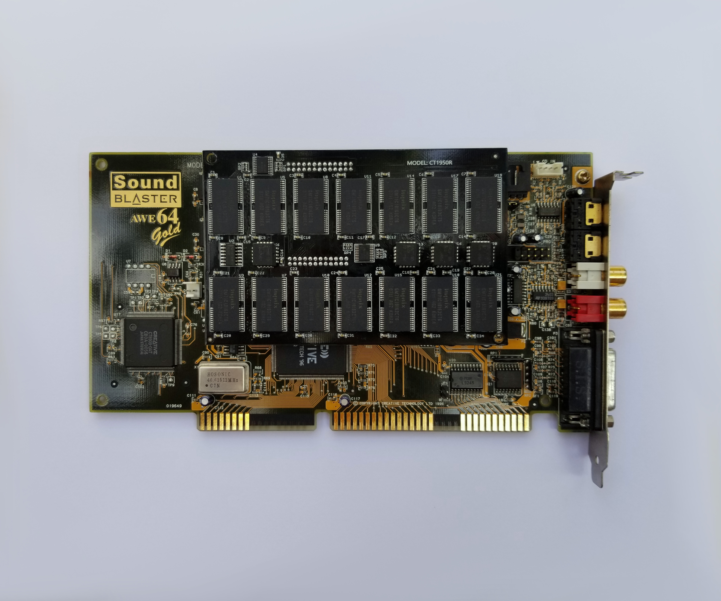

SoundBlaster AWE64 Gold (CT4390) with 28Mb RAM module - i know, grossly overpimped.
My excuse is that when searched for memory expansion module, the only one available on the Internets was this 28Mb model.
It was all or nothing situation. Went with the ALL option.

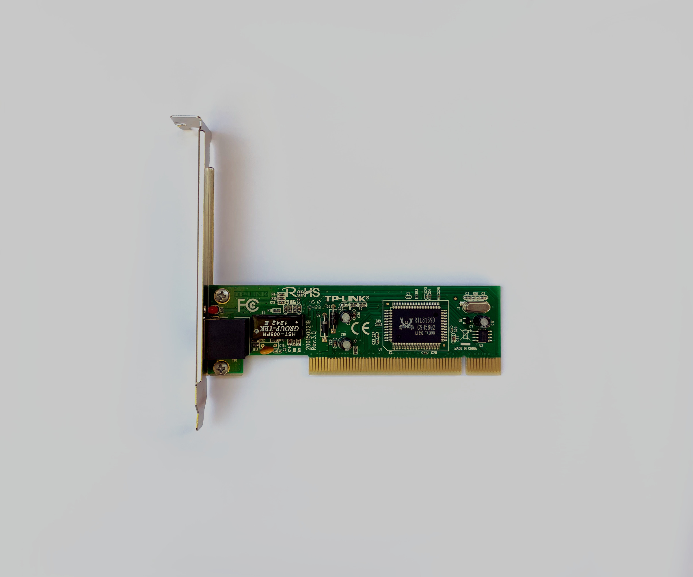

Once the system was moved to 200MHz (about that below) the 3COM ethernet adapter became unstable.
Story repeated with 1-2 other adapters.
Finally settled on a late TP-LINK card based on Realtek RTL8130D.

Had to get a bit scientific to solve the thermal equilibrium problem required for stable system without CPU water condensation.
It was not trivial. Will save you the details, but took me a moment to figure things out.

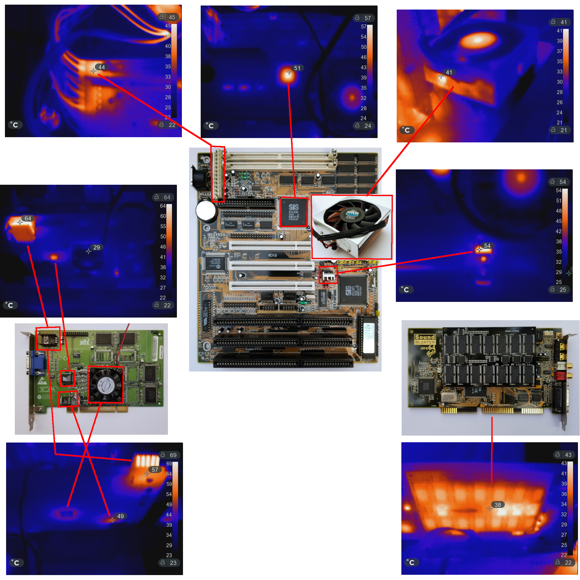

It gets rather hot inside the case - NetBurst style - very different environment compared to open air test bench.
Voodoo3's VRM is an oven. Added heatsink. Helps a bit.
SiS chipset is also surprisingly hot. Added heatsink. Helps a bit.
On-board VRM also got an extra heatsink.
Notice the power lines.

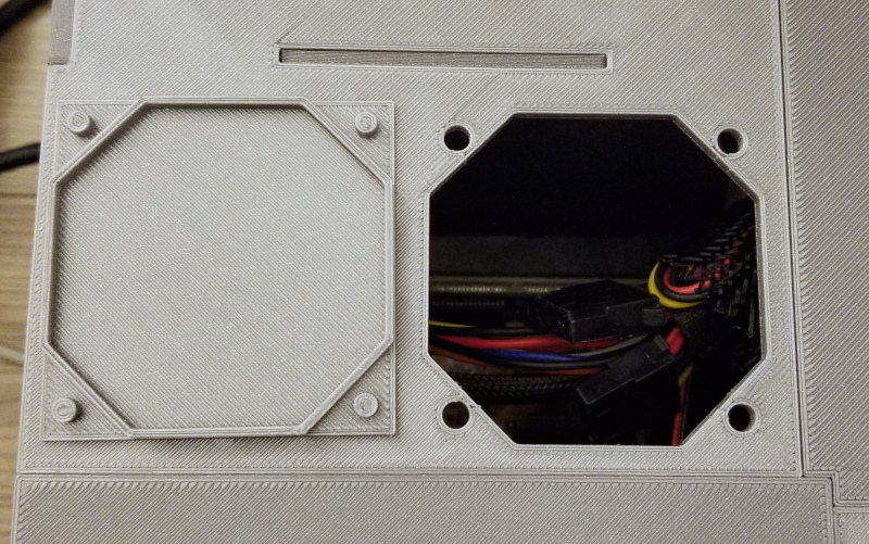

Considering the above, decided to add a fan opening - juust in case.
If the hardware composition of the rig changes, the CPU cooling unit will probably need adjustment too.

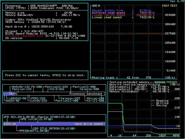

This is what SpeedSys says for the final PC configuration:
The LuckyStar LS-486E rev:D link above has all performance details of the system - won't repeat them again.
Voodoo3 matches Matrox MGA's VGA core in DOS interactive graphics, but does much better at Windows GDI.
Couple of numbers for brief reference:
                Wolf3D: 148
PCP Bench: 29.5
Doom: 71.75 fps
Quake 1: 20.3 fps
GlQuake: 32.6 fps <- !!!
WinTune2 (Windows GDI): 18201 <- !!!
Not bad, not bad.

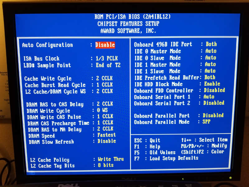

All BIOS settings on max except DRAM SPEED = FASTER.
If this parameter is set to FASTEST DOS and Windows 3.1 are pretty stable with this parameter set to FASTEST, but Windows 95 hangs.
No bus divider is possible as well.
Wolf3D and Doom benefit greatly from this configuration, but the system is not completely stable.
Needs further investigation. Leaving it for another time.
Here is what SpeedSys says - not bad, not bad:
The usual tests.
First 3 lines are for the different configurations at 200MHz.
Line 4 shows the best numbers at 180MHz.
Gray bars indicate not fully stable system.
* - indicates 16Mb RAM only and fully maxed-out BIOS settings (DRAM SPEED = FASTEST). Fully stable in DOS and Windows 3.1 but not Windows 95 unfortunatelly.
While most games/applications are CPU bound, the 1:1/2 bus divider required for complete system stability can lower framerates of games such as Wolf3D and Doom.
Quick run at 200MHz with Wolf3D, Doom, Quake 1, GL Quake, 3D Studio, LightWave3D, SpeedSys: video.

Couple of screenshots with the BIOS settings fully maxed-out (bus divider 1:1/2).
Can be achieved with one of those magical LGS 16Mb modules.

My first thoughts without edit:
Could you show a photo of how the black heatsink is attached to the peltier and how the peltier is attached to the CPU? You mentioned, "Used a plastic piece that wraps the CPU. Its "teeth" hold the heatsink", but I do not see it, nor can I imagine what this looks like.
Similarly, how is the copper heatsink attached to the peltier and the peltier to the CPU? Try running the same setup on the UUD. How hot is the power connector? If more in the normal range on the UUD, replace the AT connector on your LSD.
Are you able to run it with 60 ns memory to see if the 50 ns is necessary?
Is that one of those $165 Russian made AWE64 modules? I cannot beleive people are paying that much for these. I use the original SIMMConn modules, which I think serdashop are making now. I found that it takes too damn long to load a 28 MB sound bank. 8 MB is about the limit of my patience here.
Another thing that bugs me about the AWE64Gold, that is, aside from its many other shortcomings, is those RCA/composite style stereo jacks. I got so annoyed plugging in the 3.5" jack adapter everytime I brought out a case that I ultimately took a slot cover bracket and soldered on a female 3.5" jack.
Concerning your 3Com card - you should be able to load up the 3Com DOS config utilty to turn off that network boot feature.
Overheating the power rails thing - that is odd. I assume you mean on the connector junction on the MB. How much power does the peltier consume?
What is the cost of raw material to print that case, not including the cost of the printer?
I don't understand how your LSD's VRM is only at 54 C. Where does that 54 C come from? Is there a feature on your thermal gun to select a point and print the digital temperature? If so, perhaps move in closer and try a few different points, you might find it is closer to 61 C.

I didn't see a photo of the front of the case. Can you show a photo? Where's the buttons and LEDs, like power, reset, turbo, etc?
Reply 569 of 2521, by pshipkov
feipoa wrote on 2021-09-11, 05:00:
(the forum code auto-resizes the image - making it much smaller than it is - not sure why - hope it is good enough for you)
The attachment 1.jpg is no longer available
+ zip ties around the "teeth" for increased grip.
Between CPU and Peltier - small drops of Loctite glue in 2 opposite corners. Same for Peltier and heatsink.
Very sturdy and solid, yet easy enough to separate by applying the right amount of force.
I was concerned about this approach but turned out really well.
Also, Peltiers need good contact, so enough thermal paste needs to be applied. But the glued corners are clear from paste.
These Cooler Master coolers are badass.
Have two of them in a dual slot1 P3 rig.
Made sure this assembly fits both LSD and UUD - notice the trimmed corner.
Yes, but memory wait states need to be increased.
50ns is a must for tightest DRAM timings.
Guilty on this one.
A while ago saw a post on the audio forum about impressive sounding Doom music based on some samples lib.
Got me interested and for some reason decided to mess around with the AWE64G, despite having 2 AWE32s with maxed ram. Don't ask why.
In a moment of weakness spent stupid $ on something that won't see a lot of action.
Still regretting it. 😖
Yes, this can be annoying.
Didn't know about that. Thanks for the tip. Do you have the util handy ?
Cannot remember right now how much was the power consumption. Had it written down somewhere, but it was a lot.
No Peltier - no PSU overloading.
Initially had 300W power supply and the wires were HOT.
$45 including shipping for 1Kg spool.
Good quality material.
If you don't do reprints 486 size PC case takes roughly one 1Kg.
This one is very compact and took 3/4ths. So around $35-40 in cost.
It is around 50-55C.
Confirmed by precise thermometer probe.
Quake 1 is 20.0 'eh? That's about the same as the IBM 5x86c-133/2x with 1024K on UUD (19.8 fps). Perhaps on the UUD it will go up to 20.0. Seems like I've tested that already but the result escapes me.
It is 20 fps at 3-1-2 L2 cache timings for complete stability in Windows and some of those heavy tests.
Otherwise can use the system just fine at 2-1-2 for gaming and casual computing. In this case results is 20.4 fps.
UUD with tightest timings already does 20.1, but again, to pass the Windoes tests I mentioned it needs to go 2222 or even 3111.
Which brings it down to low to mid 19fps.
Updated the picture. Hard refresh to get it.

That photo is horrifically small. It used to be that I'd edit my photos to be under 2 MB and Vogons would not autoscale my images, but now, even under 2 MB photos are being downscaled, though not to the level yours is. Where did those two plastic holders come from? I don't see the peltier in the photo.
Are you using the red or blue Loctite? What is the curing time? I've only used that stuff on car bolts.
Yeah, even the gold's built-in 4 MB can load some pretty neat sounding sound banks. But keep in mind that these banks need Windows 95 loaded to work! Welll, there are some hacks to use them in DOS but I haven't had very good luck with that.
Unfortunately, I cannot figure out how to open zipped *.exe files in Ubuntu, so I cannot see what is in my saved files for the 3com. Archive manager can't open the *.exe and I cannot figure out how to get p7zip to open the *.exe. How is everyone doing this? So... I'll just send you what file I have in my DOS drivers folder for the 3c905-tx-m. Crappy Linux.

By the way, I decided to test the UMC IDE driver in master-mode flag (MM) with a Maxtor DiamondMax 10 and compare it to that of CF card on the UUD board. As you may recall, MM0 does nothing for single-sector transfers of CF cards, however it does wonders for my magnetic platter Maxtor drive.
CF card with UMC v3.1 /D0:16 /F0 /SM0
9,117 kb/s in Speedsys (buffered read)
Maxtor DiamondMax 10 with UMC v3.1 /D2:17 /F2 /MM2
18,946 kb/s in Speedsys (buffered read)
edit: when Maxtor is the primary boot drive, speed 17 would crash w95. So speed 16 max stable.
I put the Maxtor on the same speed as the CF card, that is /D2:16 /F2 /MM2, we get
14,406 kb/s in Speedsys (buffered read)
Another comparison is using the Maxtor in standard mode, that is, /D2:16 /F2 /SM2, we get
13,561 kb/s in Speedsys (buffered read)
Note that the "2" in MM2 refers to the IDE drive on the Secondary Master, even if there are just two HDDs in the system.

Thanks for the .exe
Worked well.
The numbers you posted are similar to what I see here.
I also noticed that 17/18 speed can be a problem.
The Awe64gold + RAM module was worth the investment at the end.
It is much more compact than awe32, otherwise the PC case had to be 2x its current size.

Upon further testing, I noticed that the Maxtor could handle D0:17 /F0 /MM0 without corruption on the Secondary port, but not on the bootable drive. But to be safe, I put it down to speed 16.
