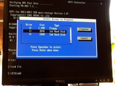

Reply 12 of 36, by xtgold
Norton disk doctor in dos 7.10 shows it as a 357G drive
the 246m is a usb cf card fat32
    194.75 KiB
    1185 views

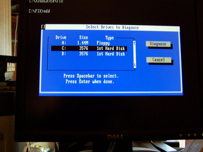

Reply 15 of 36, by xtgold
fdisk refused to make a new partition,said the disk was full.
I used aomei partition assistant in win 7 to make a new fat32 partition 357G like the 1st.
DOS booting on C wouldn't recognize the new drive.
That was rude.
I used hirens boot cd 15.2 parted magic to make partition 2 lba like the 1st.
Then dos recognizes the 2nd drive.
The last 1.2 Tb of the 2Tb drive I made a ntfs partition for vista or win7.
DOS norton disk doctor running on c:
gets the size right
    148.58 KiB
    1092 views
