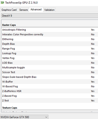

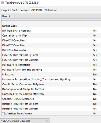

Reply 11 of 19, by agent_x007
Like those ?

Reply 12 of 19, by Scali
agent_x007 wrote:
Like those ?
Maybe... Real DXCapsViewer looks like this, but perhaps GPU-Z gives you the same info, never tried:
