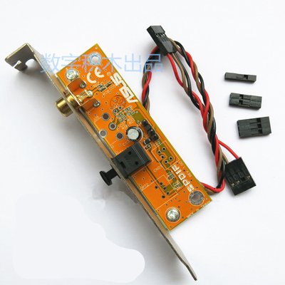

In an attempt to clean up the wiring on my system, I'd like to change how everything is currently connected. My plan is to connect 2 x MIDI 5 Pin DIN Connectors (one for MIDI In and one for MIDI Out) and connect the SPDIF Out to the Audio Interface Bracket to the 40-pin header on my Creative Labs Sound Blaster Live! 5.1. The potential problem is that the Sound Blaster only has 2 x +5V Power Supply connections, but I need 3.
I got the idea to use the Audio Interface Bracket from PhilsComputerLab (A big thanks if you read this).

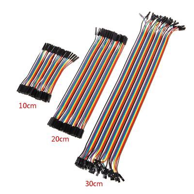

Also there is some adapters you can use instead of moding a 40-pin ribbon cable.
I like to use the adapters with Rasberry PI wires.
No soldering needed and easy to setup and trouble shoot.

Reply 6 of 47, by w0lf42
I saw that video and initially used that idea. I ran out of PCI/ISA slots, so that isn't an option for me anymore.
Also, I was using those rainbow cables, but they get loose after a while and I had them disconnection from the 40-pin header. Also, I need to connect them to 3.5mm headphone/audio and RCA connections. So, technically, I could have done that without soldering, but this is cleaner solution for me. For a solder-free option, I completely agree with you. That just wasn't the solution I needed.

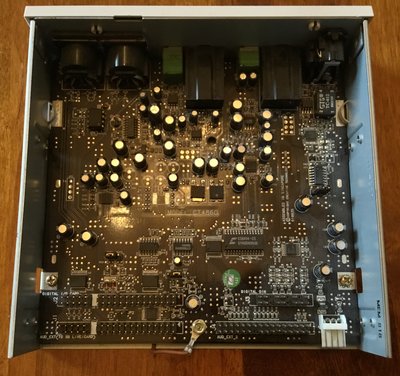

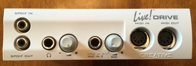

Update:
Here is a photo of the SB_Live Drive.
It has several connectors for Digital and (2) 40-pin for Audio. One to connect to the PC Card and another I do not know for what.

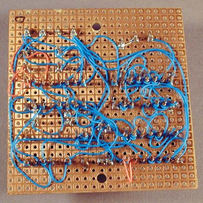

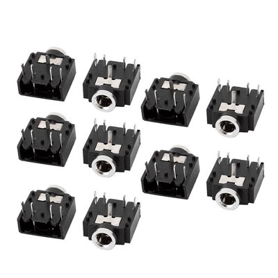

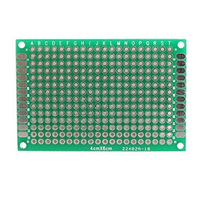

Can you write up a diagram with what pin connections you used for each connector of your 40-pin Ribbon mod ?
Maybe you can make a PCB board with all the connectors you need ?
Just solder the connectors to the PCB board and then use wires on the back of the PCB board to make all the connections between components.
You can design the ultimate SB Live PCB with all kind of connectors. Even add a connector the the SP/DIF Toslink back plate connection.
Just solder the 40-pin connector to the PCB board and connect the PCB board to the SB-Live card via 40-pin ribbon.
    116.15 KiB
    7444 views
    146.4 KiB
    7444 views
    237.51 KiB
    7444 views

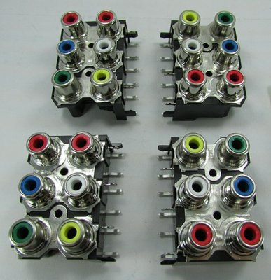

    117.24 KiB
    7444 views
    300.26 KiB
    7444 views
Reply 12 of 47, by PARUS
w0lf42, great work!!! You have your own talent and taste!
I have to say that Audio Interface Bracket is NOT "from PhilsComputerLab". I have been using a same bracket for many years. And I'm sure that not only me.
40-pin pinout is a well known information for Live, Audigy and X-Fi.
S/PDIF TTL output doesn't need additional power and has signal amplitude 2,5-5V.
S/PDIF COAX output doesn't need additional power and has signal amplitude 0,5-1V.
S/PDIF OPT (Toslink) output needs additional power (usually 5V) for supply optical element.
I covered all this a long time before Phil's videos were released, when he even didn't think about it.

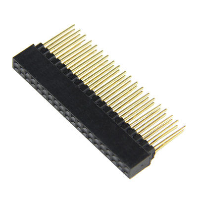

Reply 16 of 47, by Intel486dx33
doaks80 wrote:
PARUS wrote:
It's not the next to 40-pin connector. It's a PART of 40-pin connector. It contains SPDIF0 OUT, SPDIF0 IN, +5V power supply. htt […]
doaks80 wrote:
What's the smaller pinout next to the 40pin connector on the e.g. audigy2? Bit smaller than the joystick port which is separate. Not the 1394 which is at the top of the card. Looks a lot like those audio headers found on motherboards.
It's from 2004! I've been using info at this picture since 2005.
OK...are there any generic connectors that plug into the SPDIF pinout for PCI brackets with audio connectors, e.g. like this SOYO one on amazon: https://images-na.ssl-images-amazon.com/image … hL._SL1500_.jpg.
Did Creative ever make PCI bracket like these for live/audigy/x-fi?

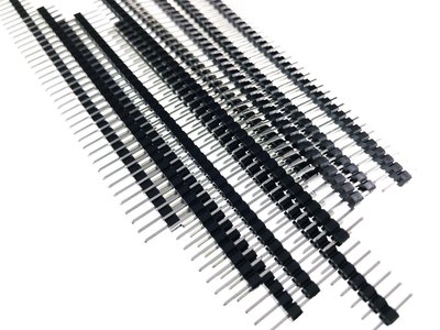

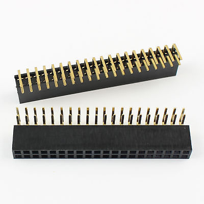

That's what I am saying. You can build your own Ultimate PCB board with all the connectors you want and just use a 40-pin ribbon from the Sb_live card to the PCB board.
You can use one of these 20-pin strips of pins and just cut off 3 pins and solder them to the PCB board. Use wire traces to make the connections between the 40-pin connector and the 3-pin connector for the TOSlink. And then just plug-in a Toslink SP/DIF back plate. of which you can find on eBay.
It's only a 3-pin connector.
    286.73 KiB
    7335 views
    237.51 KiB
    7337 views

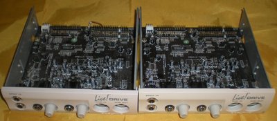

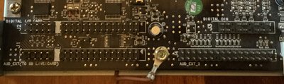

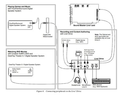

Reply 17 of 47, by Intel486dx33
Does anyone know the pin-outs to these connectors from the SB_Live drive ?
    72.34 KiB
    7278 views
    89.79 KiB
    7278 views
    86.78 KiB
    7279 views
    394.7 KiB
    7333 views
    201.69 KiB
    7333 views

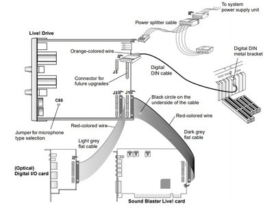

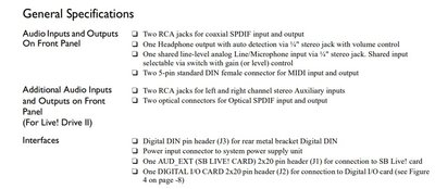

Reply 19 of 47, by PARUS
Intel486dx33, J2 connector is a total clone of 40-pin header on the base card. I.e. you can connect Digital I/O card not only to LiveDrive but on base Live card too. There are two versions of Digital I/O card:
image?p=3441&i=1
I have LiveDriveII module and I usually use the second S/PDIF INPUT directly on TTL level without any digital I/O cards from Creative.
The J3 connector for digital DIN cable may present not only on LiveDrive but sometimes on base Live card. But missing some contacts. For example CT4670.
The J4 "for future upgrades" as I know was never utilized by Creative. For what they made it I don't know. But surely there were some plans. It is very interesting to know its pinouts.
When LiveDriveII was released it had already COAX input and OPT input but it was ONE a SAME S/PDIF input and on PCB was placed jumper to switch them (coax/opt). The second S/PDIF input is available on J2 connector.
When Audigy1 was released the 5.25 Extension was made on same PCB as last LiveDrive IR with remote control. But at that time Creative didn't solder no one connector except J1. The J4 "for future upgrades" was absent too 😀
All LiveDrive modules and Audigy modules have a same pinouts and fully compatible. I use LiveDriveII (my favorite) with an Audigy card.
Audigy2 has another pinout on its 40-pin header and another 5.25 Ext PCB (not compatible to Live/Audigy1). Its PCB has only one header for connecting to base Audigy2 card plus one IEEE 1394 header. X-Fi has the same 5.25 Ext PCB (like Audigy2) but without IEEE 1394 connector soldered.
