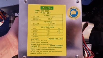

Anyone ever come across power supplies from a manufacturer called Zeck?
I've recently got my hands on two inexpensive AT PSUs, one from Liteon (which appears to be a Compaq proprietary model) and a standard AT from Zeck, model ZKS-520T.
Google suggests that it's mostly used for industrial systems, which to me suggests that it might have good build quality, but I was just curious if anyone has ever used one, and how good people consider them to be.

I'll take some pictures later. Had a quick look yesterday. I saw a couple of large Panasonic caps in there, but couldn't identify the others.

Right. Took some pictures of the guts of the thing. I'm unable to identify anything other than the who large Panasonics.

Those 470uF primary caps are well enough for 200W total power. There is minimal EMI input filtering. There is a bridge rectifier, probably 4- 6 Amp one. Primary switching seems to be done by 2SC4130 BJTs in this half bridge arrangement. 2SC2625 or MJE13007 might be a better option depending how much the circuit is optimized. Main transformer seems to be 35 size with center tap for secondary common ground. Enough even for 250W total output. That current sensing coil glued to the pcb with the wire going through it looks a bit kludgey but only aesthetically.
HA17339 does the primary pwm. TL494 comparator is practically the secondary housekeping and power ok generator chip. On the pictures only a to-247 package output diode is visible. This is the 5V rail rectifier. Probably a 30-40 Amp Schottky. 12V might be done by a 10- 12Amp double diode. Only the TO-220 diode casing is visable.
Those GPE caps on the secondary output filter look wierd without a top vent, but probalby have one on the bottom. The unit could use a fan controller circuit, but only if the fan is loud. This PSU can easily power even a beefy Pentium build.
