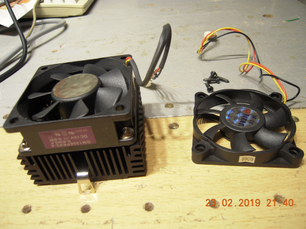

Reply 14 of 33, by retardware
I'd say, if you make sure that the fan on the S7 cooler is adequate, your K6-3 450 will probably run fine at 600MHz.
On the right hand you see the puny original fan of the S7 cooler, which doesn't look very trustworthy, on the left you see the cooler equipped with a quality Japanese fan scavenged from a DLP projector.
