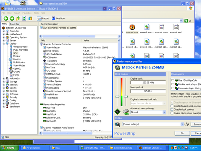

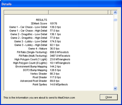

Hey everyone. I bought something called a Matrox MED2mp-DVI that looks like an AGP Parhelia 8X 256MB. I got it up and running Parhelia drivers by force installing them in device manager. Otherwise I'd need some special driver package from another company. The clock speeds are interesting - 2 different programs say core is only 162 MHz but the RAM is at 325 MHz. I think that core clock reading is incorrect though, because 3DMark2001 shows fillrate well above the original 220MHz Parhelia. I suspect it's actually 250MHz.

I ran everest and 3Dmark on my Parhelia 8x 256MB and I added the pins file as an attachment. Seems like performance is close to my card.

Thanks for the pin info. Yeah it looks like the cards are operating at the same speeds. I tried flashing your pins file but that didn't seem to work. It looks like pbioswin works in slightly mysterious ways and won't allow changes to some parameters.
