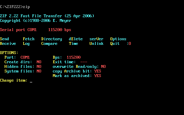

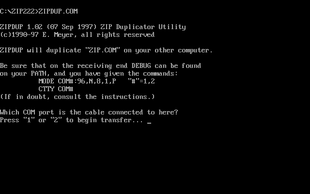

Reply 5 of 9, by lolo799
The server part of Interlnk (Intersvr) can copy itself over a serial connection.
You could try Zip instead, it has more options, can be menu driven and can also copy itself to a second machine: https://www.sac.sk/download/comm/zip222.zip
4.94 KiB
1915 views
4.66 KiB
1915 views
It works fine with the onboard serial port, but not with a USB-serial adapter, it can't establish a connection.
