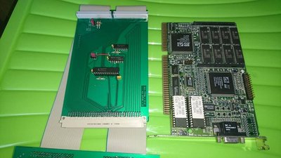

im looking for a 2mb dram memory module for a mach64 memory card, it has to be dram memory modules.
its to fit on the card to the right,

This can be tricky. The modules were normally not used on the VLB or ISA versions of this card, but they were used fairly often on the PCI version. Normally the most economical way to get one is to buy a PCI card with the expansion, and swap it. Unfortunately, there are several different versions of the upgrade, and only a few of them work on the ISA/VLB version. You should probably try to pay close attention to the part numbers.
To be honest, it's not really worth the upgrade on the ISA version, because anything above 1024x768 will be too slow to use.

the adaptor on the left is for an old atari, going isa is the only solution unfortunately, the adaptor converts isa to a format the atari can understand. i was under the impression that all pci cards using vram and not dram, i will do some more digging,
dave
Reply 6 of 18, by kixs
Your card uses VRAM memory. Non the less you need an expansion card with the same memory configuration. Only an early PCI version used the same memory. Later ones are not compatible.

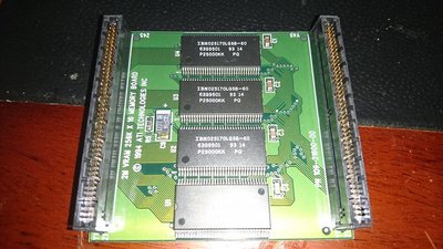

just so happens i have one of these, wonder if its compatible,

Maybe one of these:
https://www.ebay.com/sch/i.html?_from=R40&_tr … ati+ram+upgrade
It looks like the upgrade card might be the same as the one for the PCI MACH64:
http://www.vcfed.org/forum/showthread.php?449 … -upgrade-module

I am somewhat certain the cards with the 109-31600-XXX part numbers do not work...at least the one I tried on mine did not.
It's not.
