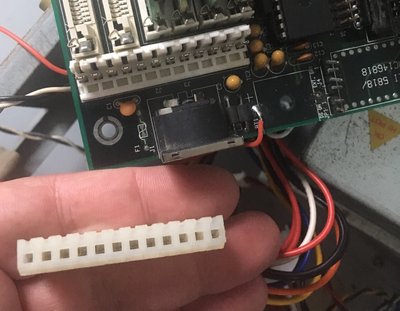

Long story short. Using the case from a 386, to put a board for a 486 in.
Case was not idea setup, a lot of modding the case to get things to line up and work.
Want to use the power supply that is already in the 386 case, however, the way the PSU connects to the mother board, while both 12 pin connects, does not fit. The way they connect is different.
Can I just desolder the 486 Motherboard connection and and 386 motherboard and swap?
Just wondering if the pin out would be the same on each?

It's almost certainly the same AT-style connector, and it almost certainly will work if you can physically make it fit, but there were a couple of different styles of AT power connectors.
This is the normal, friendly AT power connector:
This is the cheapo, terrible awful no good "AT" connector that is a real pain to work with but electrically compatible:
Bad pic, sorry. If this is what you are dealing with (and somehow I doubt it; I've only seen them on XT era boards) you can make it fit using some well-meaning violence.
Post pictures and we'll be able to tell you for sure 😉 If it doesn't look like either of the above you could possibly have a weirdo proprietary 486 OEM board, in that case you need the correct pinout to build an adapter.

Here’s the issue. So the side with the lip would go towards the pins ! And cut that lip off ?
Reply 5 of 11, by einr
Yes, on the cheapo kind of connector, the connector is secured by having the lip go under a wavy piece of plastic like on the left (I don't really know what to call it in English to be honest):
On the real AT connector, like you have on your 486 board, there are keyed "slots" that go into the vertical part of the connector. This is tough to draw but you can see what the connector should look like in the photo I posted before. The lip is going to get in the way of this part. Also, since you don't have the plastic tabs that go into the slots, if you do get it to fit, it's going to be a loose fit. So you need to tape it down good or use hot glue or something.
This is kind of difficult to explain in text but hopefully you understand... 😀
You should probably post pictures of the colors of the wires coming from the power supply just to make 100% sure you put it in the right way, too.

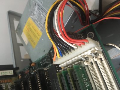

Reply 6 of 11, by 90skidJohnny
The attachment 1F282505-C615-46D4-88B3-6BDFF100B4E0.jpeg is no longer available
Ok after sanding and cutting and sanding. I got it to fit. (ALS I really need to buy a rotary tool one day. How this look ?
Reply 7 of 11, by einr
That looks good. Colors seem to be in the right order. Power it up! 😉

Reply 10 of 11, by einr
That's unfortunate. 😢 Shouldn't be the power supply's fault at this point though.
I noticed some bent headers in your photo earlier, looks like this board may have had a rough life..?
