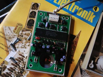

Reply 11 of 14, by Jo22
Now that's a surprise! At some point, the old Genius mice also had got an 8042 derivative inside. Haven't expected that.
    389.84 KiB
    1641 views

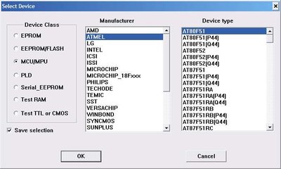

By the way, some of the modern 805x/875x are pin compatible with their MCS-51 ancestors and contain internal EEPROM/Flash-ROM.
These can be used with USB programmers such as the G540, for example.
- I'm currently trying to program one of these (AT89C51RB2 series w/ 1KiB XRAM, 16-32KiB Flash, 256 Bytes Scratch Pad RAM),
so it could act as a replacement for my 8052AH-BASIC chip (these are really rare nowadays).
So maybe there's also a chance to "port" an 8042 Keyboard-Controller to the
later generations, not sure. I'm just starting to understand this platform. 😅
