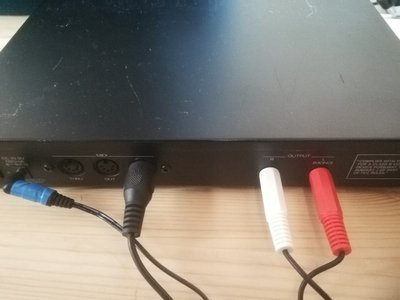

Connected from SoundBlaster gameport to MT-32 IN port.
1.18 MiB
1132 views
Connection to SB AWE
From MT-32 ordinary audio cable to IN port on SB card.
From SB card to speaker.
1.85 MiB
1132 views
Connection to the device
I have tried several Lucas Arts games with no luck.
I get SFX but no music. There isn't any sign of contact with my computer and the MT-32(shouldn't the mt-32 pop-up messages?.
I have tried the MT-32 at a friends computer, who runs DOSBox. Worked flawless. Nothing wrong with the device.

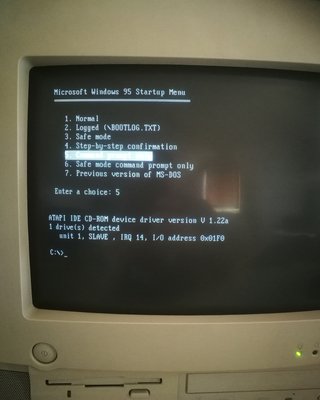

STARTUP IN DOS:
1.14 MiB
1132 views
Start Up

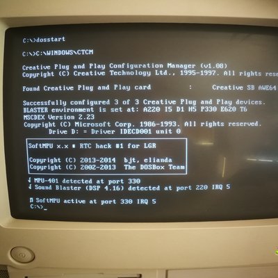

RUNS DOSSTART.BAT (with soft mpu loaded)
1.46 MiB
1132 views
DOSSTART.BAT
