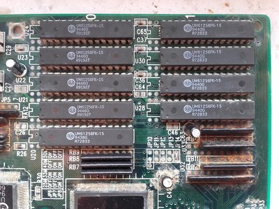

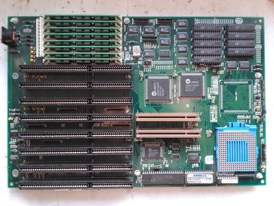

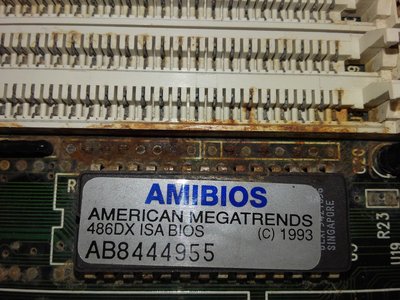

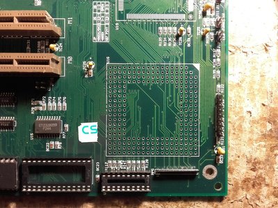

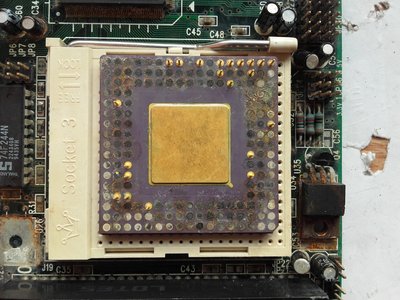

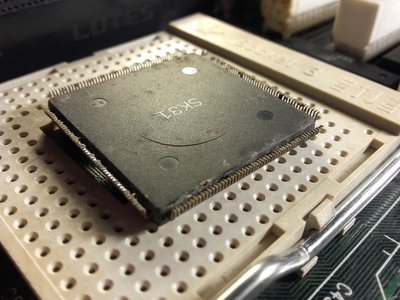

Continuation from this dumpster find thread post. To my surprise, PCB looks OKAY, no rotten traces, pads or vias, but most of the soldering alloy, used on it, had rotten off, taking with itself some passive SMD components. All of the resistor packs were also heavily corroded as its legs were made from iron... Some of them fell off just by touching them. Main chip is held only by one pin row, it's possible to lift it up now, though badly corroded, all legs seems to be rigid. Cache chips are legit, made by UMC (UM61256FK-15), CPU did not fare well at all 😢
1.64 MiB
861 views
1.48 MiB
861 views
1.4 MiB
861 views
resistor packs
1.47 MiB
861 views
1.34 MiB
861 views
In conclusion, it's restorable, but to do that, motherboard needs to be stripped off of every component on it, cleaned of corrosion and reassembled.
Reply 1 of 20, by SSTV2
I think I'll just salvage CPU socket for this motherboard, it's been waiting for socket transplant for a few years now.

Reply 2 of 20, by Deksor
Make sure the pins in the socket are still ok, which I kinda doubt looking at the CPU's pins ...
Weird that they did put legit cache chips and didn't socket them, that's what they do most of the time. Maybe they're still fake ?
alternative
Reply 3 of 20, by SSTV2
I had removed top plastic off the socket while washing MB, all of the pins were fine, except one, that was pushed in. Overall, CPU socket and ISA slots had preserved phenomenally. I also do find it strange, that legit cache is soldered in, probably they were trying to save every cent in manufacturing process.

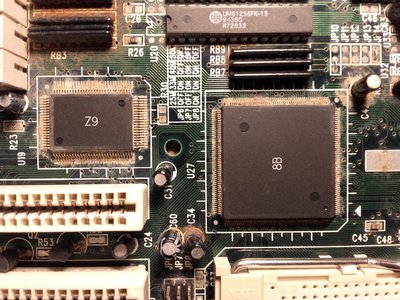

Reply 5 of 20, by Deksor
Probably nothing of interest, PCChips often did that in the 486 era, underneath there's just a single digit number and that's it. However the chipset of these m912 is really a UMC chipset. But they often put other stickers there.

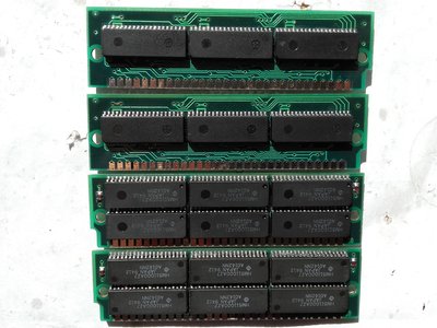

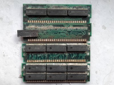

Restored memory modules from this:
1.3 MiB
680 views
To this:
1.18 MiB
680 views
4 Megs total, tested good.
Interestingly, these modules are using ICs with ZIP through-hole type case, which are converted into surface mount type.

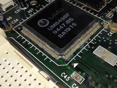

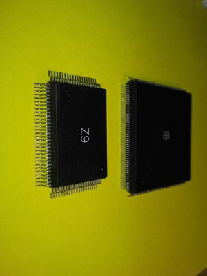

Also, removed chipset, but both chips had cracked at the underside, due to vapor pressure from absorbed moisture in the plastic... I hope that crystal didn't move when case poped and bond wires are still intact.
1.13 MiB
680 views
Chipset ICs after restoration:
586.03 KiB
680 views

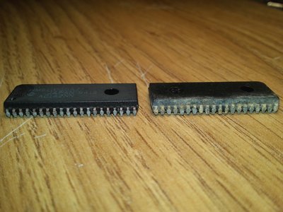

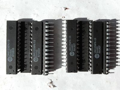

I've also desoldered and tested SRAM ICs, now I know exacly why they've soldered BIOS and cache in. "TAG" and ICs at "BANK 0" are legit, but ICs at "Bank 1" are all fakes 😀
Can you visually tell apart which are which?
1.31 MiB
680 views
Fakes are just plastic with legs, measuring resistance between Vss and the rest of the pins, shows infinitely large resistance.
Reply 8 of 20, by Deksor
For the cracked chip you can simply replace it with a regular UMC chip, because this is what these are.

Reply 10 of 20, by Deksor
Well it does, look at this https://www.ebay.fr/itm/UMC-UM8498F-Baby-AT-3 … 4.c100408.m2460
Mustn't have been very popular though

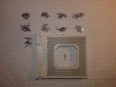

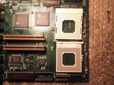

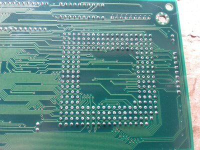

I've decided not to waste time trying to make PC Chips MB post and just salvaged its socket 😀
The recipient is prepared for socket transplant:
877.63 KiB
572 views
830.67 KiB
572 views
Reassembling socket after days of trying to whiten it:
619.5 KiB
572 views
902.16 KiB
572 views

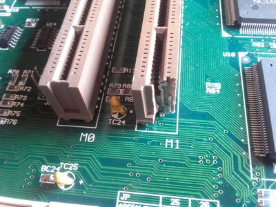

Wasted nearly a week trying to whiten that socket. Kept it in hydrochloric acid for few days - no go, hydrogen peroxide and UV for at least 3 days - no go, only scrubbing it with hard tooth brush and polishing paste did help. Any ideas how could that chipped VLB slot be patched nicely?

Reply 16 of 20, by SSTV2
Hot air and flux alone wouldn't do it, the oxide layer was just too thick for pins to tin, basically layers of lime had formed on them.
Pins had to be cleaned off thick layers of tin/lead oxides first, used diluted hydrochloric acid for that purpose. Once thick layers of solder alloy oxides had fallen off the pins, I've removed ICs from acidic solution.
After that, pins were still covered in very thin layer of oxide, so acid based flux had to be used to tin them properly, as tacky "Amtech" flux was not good enough. Used regular soldering iron in the tinning process, as some scrubbing was needed.

You're being very brave to restore such a piece of garbage of a motherboard. 😵
This is one of the infamous PCChips motherboards with fake cache and counterfeit chipsets. According to the Red Hill guide, the M912 was available not only with the UMC "sticker", but also other ones, including Intel. So basically they just used a chipset (or ripped off an already existing one), put a sticker on the chip according to what the customer wanted, and sold the M912 with any chipset they wanted, as if the fake cache chips weren't enough...
More info here: http://redhill.net.au/b/b-bad.html
I hope the traces of the fake chips actually lead to somewhere, otherwise you'll end up with a quite crippled 486 motherboard, if it ever comes to life. Oh, assuming the cache actually works. On fake cache motherboards, the BIOS was modified in order to keep the L2 cache feature disabled regardless of the user's choice. That's why they soldered the BIOS chip: not only to save costs but to also avoid that someone would discover the scam. Perhaps the motherboard might even POST without any cache at all, even though the option in the BIOS would be set to yes!
Ironically enough, when PCChips motherboards worked properly and used legitimate components, they were some of the fastest motherboards available on the market. But their shady practices and low quality construction just made them utter rubbish.

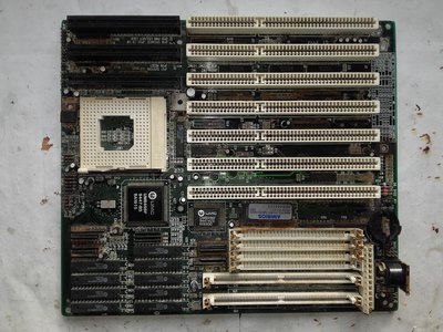

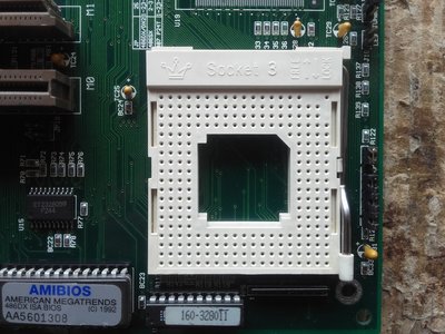

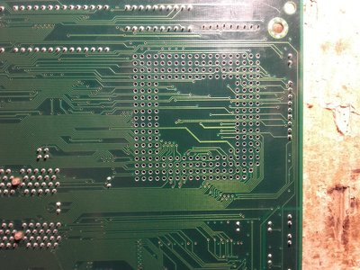

Success:
1.21 MiB
373 views
1.49 MiB
373 views
This motherboard has a huge flaw in PCB design around CPU socket. It definitely doesn't meet power integrity requirements for 100MHz+ CPUs.
1.2 MiB
373 views
Any suggestions how could this be fixed W/O resoldering the whole thing?
