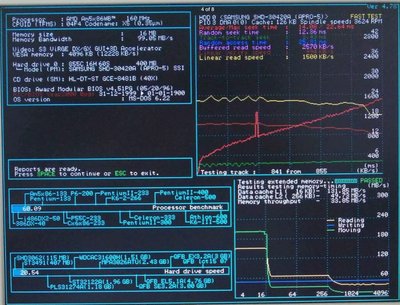

Hey guys,
Just posting this because i have hit the limit of what i can figure out or find info for.
I want to overclock my 5x86 133 to 160mhz on my Gigabyte Ga 5486al board.
Hardware is:
32mb FP edo
s3virge dx 4mb
canopus pure3d
sb16 vibra ISA
an smc 10/100 isa nic
By all accounts, i cannot see why i should have issues. If i leave my multiplier @ 4 with standard voltage and just set my jumpers to 40Mhz, the pc just will not boot, and gives the beep code for VGA fail. So, i am thinking it has to be a PCI bus speed issue.
However, i cannot adjust my PCI bus speed multiplier and my ISA bus is at CLK/4, and the beep code does not happen with all cards out of the machine. But i have tried other PCI graphics cards with the same issue.
Is the something i am missing here? Or is this board just no good for overclocking?
And I am also hunting to squeeze every last drop out of this mobo/cpu combo just for fun. so if there is any other suggestions, i'd be glad to hear them.

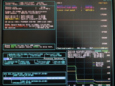

Reply 2 of 22, by Intel486dx33
Here is a image from “Speedsys” program of what your benchmark score should look like for the GA5486AL over clocked with an AMD 5x86-133-P75 @ 160mhz.

Reply 5 of 22, by feipoa
Does it work with L2 cache disabled and memory timings set slow? Single-banked cache implementations, such as that used on this board, will not handle fast timings at 40 MHz. Also, try a simple graphics card, like a Virge.

Reply 7 of 22, by saKKuth
Well i'll be damned!
Thanks for the help guys, great success!
I ended up just switching it to 40mhz with the 4x multiplier. Then disabled L2 cache, turned the memory timings to the slowest and then BEEP! it booted..... Happy times. I had done this prior, but never turned off the L2.
Then i turned on the L2..... BEEP! my jaw dropped.....
so, i thought let's just go all in.... Turned all my timings to 2-1-1-1 and set them to fastest.....
BEEP! what the hell???
Anyway, stock voltage 160Mhz and boots to windows without skipping a beat..... Here's my speedsys results.
This is why playing with old pc's is fun.... Because it seems you just need to choose the right day and hold your tongue the right way to get results!
