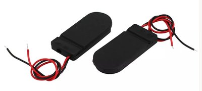

What type of battery do you use with a 486 motherboard Dallas battery coin adapter ?
Reply 1 of 18, by Vynix
A normal CR2032 battery is enough in most cases...

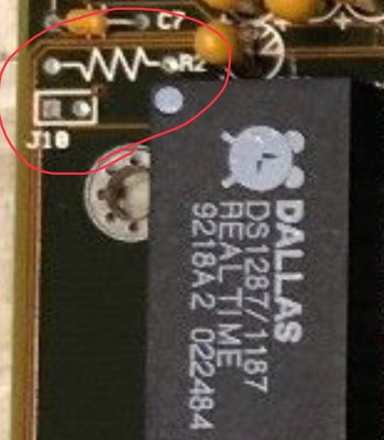

I am wondering if I can solder the coin battery housing wires to the motherboard location for a barrel battery and then maybe jumper a wire for ( jumper J10 ).
Reply 5 of 18, by Intel486dx33
dr.ido wrote:
That's not the symbol for a barrel battery. That's an unpopulated resistor.
Okay, thanks.
Looks like I will just have to dremel into the battery.

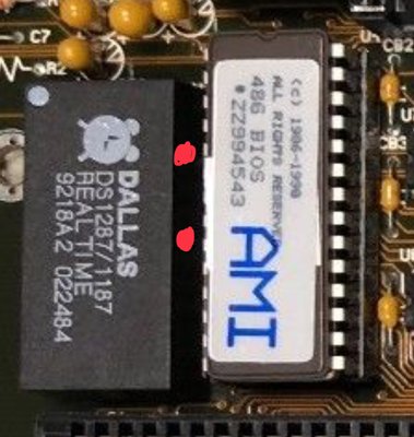

Looks like i’m Going to have to drill into the side of the Dallas next to the BIOS chip.
What a pain.
Anyone do this before ?

Well, I would if I could. But the dallas is soldered to the motherboard. So the easiest solution is to just
Drill into the dallas and solder on a coin battery holder.

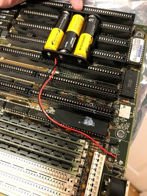

What I did for my 486 board was almost the same as suggested, you can cut into the Dallas battery (very carefully) until you reach both the positive and negative lines. I didn't use a CR2032, what I did was buy 3x 1.2V *Rechargeable Ni-cad batteries & stuck them in a small pack, then soldered the leads to the + and - lines you cut into. It's a bit tricky, but once done, you'll never need to worry about the battery again.
Reply 13 of 18, by jmarsh
How do you expect them to recharge? They'll be dead within a month or so.

Reply 15 of 18, by dave343
240.35 KiB
1500 views
This is what I ended up doing for another one of my 486 boards, but it had the corroded barrel battery. You can do this same setup for the Dallas battery, you just need to cut into the battery and solder onto the + & - leads inside.

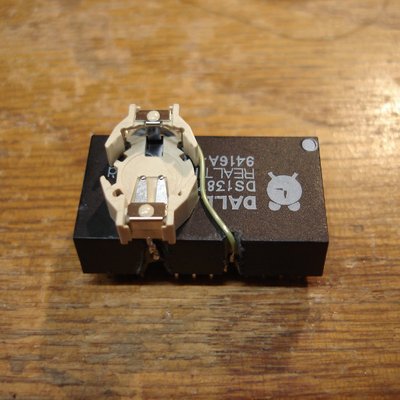

I've noticed all my 486 boards have exactly the same topology, so I've traced the circuit, drawn a schematic, and modified them to put the battery itself behind a diode, while still allowing the board to run the RTC from the +5V rail when powered on. Then, there's usually a 20mm-spaced pad on that battery area on the motherboard where you can mount a primary coin cell holder for easy maintenance every 15-20 years or so.
I don't think that helps with the 12C887-style circuits, since those assume a primary cell as part of the module. For those (a PS/2 and a couple 386 boards), I made a replacement PCB with the 885 variant RTC (no integrated battery or crystal) and a coin cell holder. The picture above looks more like the 486 boards I've ended up with, though. Those have a discrete crystal oscillator circuit built around a hex inverter, then the battery and 32kHz clock run over to the chipset. There's no dedicated RTC.
Reply 17 of 18, by jmarsh
No you can't. Barrel batteries get recharged when the PC is on, Dallas batteries do not so replacing them with rechargeables is a waste of time.
Reply 18 of 18, by Intel486dx33
I found these how-to's.
Just need to drill under pins 16 and 20.
