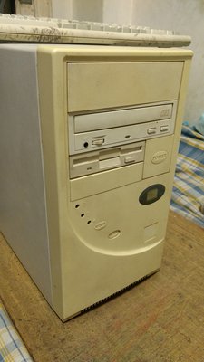

The computer itself

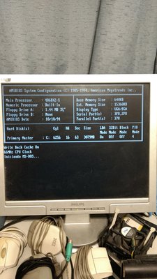

BIOS stuff and running MS-DOS 6.22
Specs in BIOS screen and the video card is a S3 Virge 375/385 with 2 megs of RAM and an ESS1869 sound card

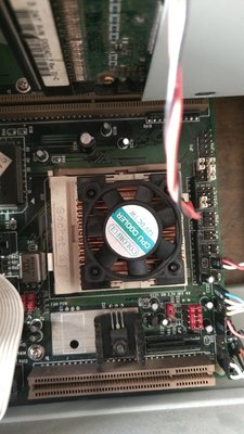

another thing that comes to mind could be a faulty voltage regulator, not sending power on 3.3v need to measure with a multimeter to confirm you are getting power into socket when jumpered at 3.3v also would be good to try other slower cpu at 3.3V like dx4 100 or dx2 66 3.3v version but not everybody has alot of parts I understand that
Reply 13 of 17, by Nipedley
Probably the board came in two configurations, one with voltage regulator and one without. The board still has all the jumper settings but they do nothing, because the regulator isn't there to produce the lower voltage

I tried at 25 MHz... nothing, I'll share a pic of the board's processor area

Reply 17 of 17, by treeman
looks like something missing from factory on u11 need somebody with same board that has confirmed 3.3v capability for comparison
