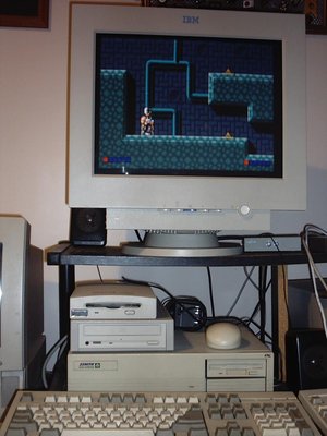

Currently having lockup issues with my Zenith 286/12 (Z286LP-Plus)system. An interesting thing about this is Zenith advertised this as an Windows 3.0 system giving it the ability to have 8megs of ram. It would normally freeze after 10minutes or so and not turn on occasionaly. A few weeks ago I tried to sort it out but gave up in frustration. Tonight I decided to fire it up again to give it shot. I thought what dos application could I use to do some testing and fired up Star Goose. It's one of the earliest vga scrollers that will just keep running without interruption. Fired it up to let it run. Sure enough the system froze and gave a nice parity error.
Another issue I had was that for some reason the fdd cable was faulty this seems to be why the system wouldn't start. Replaced the cable and it is booting fine.

It is a slimline design with two serial ports, one parallel port and VGA video on the planar. The cpu is on a card the lays flat at the front LH edge of the planar. There is an option to replace it with a 386SX/16 board. The keyboard port to the left of that on its own card. Looks like it could be upgraded by just replacing the card and setting some jumpers. You plug the AT keyboard into the DIN socket in the front of the machine. There is room for one 3.5" fdd and one 3.5" hdd. These have a guide that is fitted to the LH side and screws on the RHS as you'd expect. It does have 3 ISA slots on the riser.
The bios is gotten at by holding down the ESC key on start up and then typing SETUP at the prompt. Typing a ? gives a few more options and typing TEST brings up a list of advance diagnostics tests you can do on the system. When in setup you can change the usual stuff such as fdds, hdds, ports etc. The hdd area has something like 60 hdd type selections but no option to set your own parameters that I could find. Most likely will have to set up any drives bigger than about 240megs using DDO software or other means. Not a problem really. The ribbon cables in it currently are fairly long so I'll fit some shorter ones.

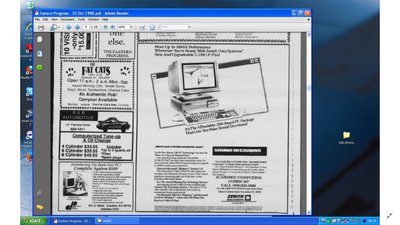

Found a pdf with an old advert in US newsletter.
