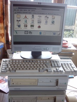

A good resource site for RiscPCs http://chrisacorns.computinghistory.org.uk/Co … /RiscPC600.html

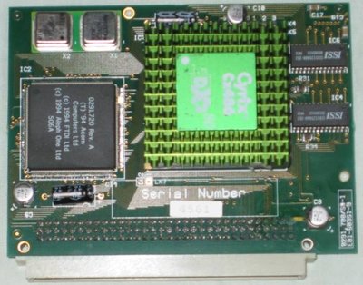

Example of a x86 co-processor:
48.49 KiB
1344 views

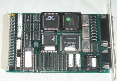

Example of a podule x86 card:
46.45 KiB
1344 views
These cards came with software to integrate with RiscPC. You can run Dos and Windows 9x depending on the card fitted. I have Windows 98se on one of my systems.

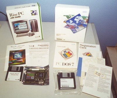

PC card fitted:
10.72 KiB
1333 views
Bundle. PC Dos of some sort was supplied:
45.87 KiB
1333 views
