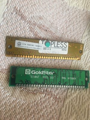

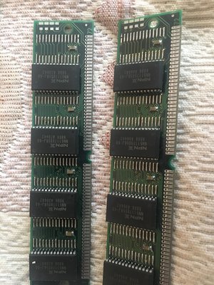

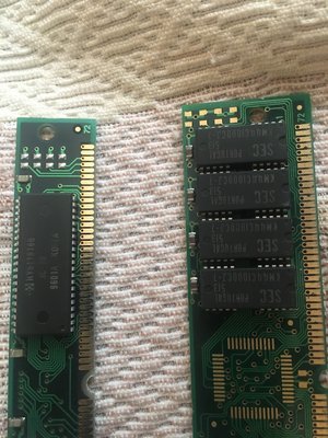

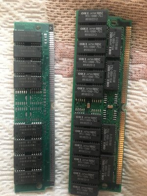

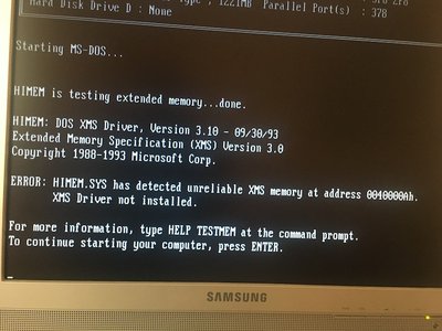

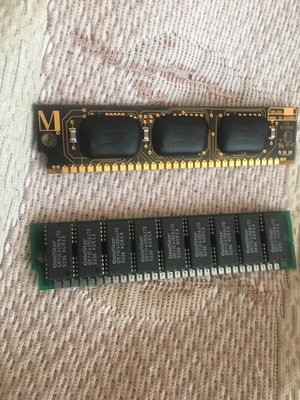

hi,
can you help me what are better for my setup?
what is your suggestion...

retropol wrote:
hi, when I removed them from my old computers 25years ago for sure they were.
Same error for all the different memory modules? If yes, it points in the direction of the motherboard - try another board then?
If nothing it broken, it could also be an issue with timing and/or voltage.
I try to run memtest on old memory before using, at least that way I know the memory is ok.
Reply 5 of 7, by treeman
try a different cpu if you have one, or at least remove and reinstall. I have had alot of cache and some ram errors on a faulty cpu socket before, reseating cpus would give different results which helped diagnose a socket problem
Reply 7 of 7, by chinny22
the last number on the chips are the speed.
So you have a mix of 60 and 70ns Ram, faster is better so 60 are the more desirable.
The Topless (hehe) simply has a sticker telling you its 60ns
So use that first, but if that doesn't give you enough (say 4MB, I wouldn't have a problem adding a 70ns simm
