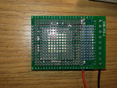

Always wanted to have one of those interposer boards for motherboards that can only supply 5V Vcc to the CPU. Spent whole weekend assembling it from parts that can be bought basically at any electronics store and it eventually paid off. Though, I would not want to repeat same experience for the second time, nor I would recommend anyone to follow my example (unless you are into masochism). No PCB designing, etching, etc. were needed, just had to widen pin holes with a drill.

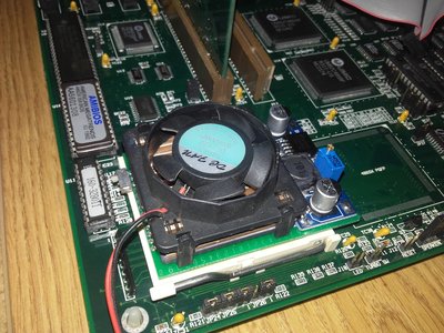

Interposer in 4DPS MB.

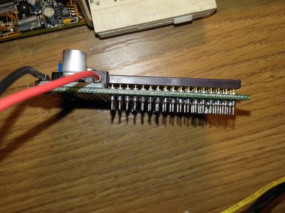

Bottom, Vcc wire and 8 bypass caps can be seen.

Soldering properly that Vcc wire was pain in the ass, probably the hardest part of all.
I'm currently using external power source (5V) from molex, If everything will be OKAY and it'll pass stability test, then i'll add power from the extra row of socket 3. So far, 4DPS posts, no deeper tests were done.

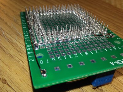

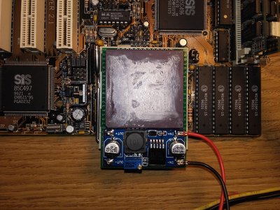

Tested module in 4DPS and UM486V motherboards with external power source - no problems at all, AMD DX4-100 CPU runs perfectly fine. Removed external power source wires and added 4 extra pins for +5V Vcc from the outer pins row of socket 3, looks pretty decent now.

I could never boot UM486V MB into OS with that CPU running @ 120MHz, no matter the timing/wait states settings, but with the interposer, it can run doom @ 120MHz 😀
Reply 5 of 25, by feipoa
Interesting. This is the first time I've seen a switching regulator on a socket 3 interposer board. I assume that the blue trimmer is to adjust the voltage? What voltage adjustment range do you have?
Reply 6 of 25, by SSTV2
Yes, trimmer is used to adjust output voltage, with load, output voltage range is from 1.3V to 3.9V @ 5V input. Max output voltage could be increased with a better characteristics catch diode, though.
Reply 8 of 25, by SSTV2
Current SS34 catch diode has a 0.5V forward voltage drop, if it were replaced with a ultralow forward voltage drop diode, lets say 0.2-0.3V, then maybe Vout could be increased up to 4.2V. Still, output voltage heavily depends on load and current that passes LM2596 IC, according to datasheet, its saturation voltage is 1.5V at 3A, which would result in even lower max Vout at heavier loads. I've noticed that @ 120MHz, max output voltage drops to 3.8V.

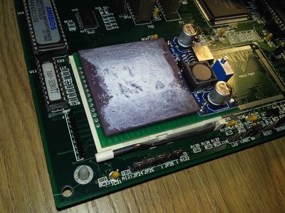

I think that I'm finally done with this thing. Soldered additionally a micro switch for an easy multiplier selection, no more switches/jumpers needed afaik?
1.37 MiB
1664 views
And yes, ability to increase volage helps to stabilize CPU during overclocking, not always neccessary, but most of the time it's needed.
Interesting thing about that motherboard is that it supports undocumented 54.3MHz FSB. Current Am DX4-100 is clocked @ 108.6Mhz and it surely beats 120MHz option in Doom, at least 3FPS avg. increase over 120MHz.
