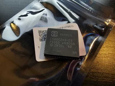

I thought 286-25 Harris CPUs were semi-rare, and to my surprise UT Source sells them in large quantities...
https://www.ebay.com/itm/1PCS-CS80C286-25-Enc … CC/382938879224 (they also have 5 pcs and 10 pcs listing in much better prices).
I already ordered 5pcs... Still I wonder if anybody bought them from UT Source? My previous experience with UT Source was fine, still I wonder if those CPUs are legit...

You are about to find out... Chances are that there is some leftover stock. I doubt that nowadays anyone uses those outside of the retro community.

Do the acetone test on them once they arrive. Soak a cotton swab in acetone and rub it on top of the chip, if markings start to disappear or the swap gets stained the parts are remarked. If you're lucky the part had its date code "refreshed", if you're less lucky the part was originally say 20MHz that now has 25MHz rating.

I've never bought CPUs from UTsource, but I have had remarked/fake STK modules and transistors from them.

We will see. I suspect these may be remarked. I bought SAA-1099s from them some time ago and they work perfectly fine as CMS though.

Ive bought a lot of stuff from utsource in the past and had no issues with remarking and such, but they are still a large volume chinese seller, you can never be sure.

Got them yesterday. That was fast.
I need rest parts (oscillators, sockets etc) for one of my Suntacs and I will mod the sh** out of it. Hopefully it will work (for now it's missing OSCs and CPU looks overheated).

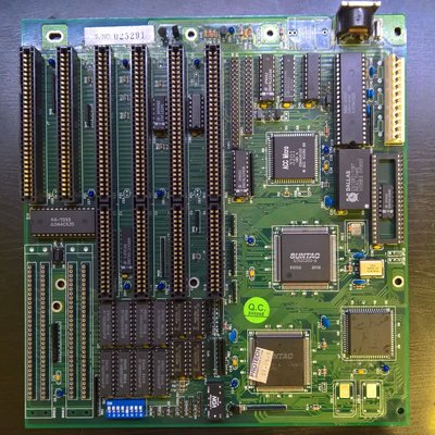

Motherboard has space for three oscillators, from what I was told:
OSC1 is for CPU
OSC2 is for FDC, if OSC1 is not 24MHz
OSC3 is for FPU running in async mode
I guess OSC2 maybe used for ISA BUS as well?
Anyway here is my motherboard which I want to mod:
The attachment 65293355_2837782576237080_2919844541643096064_n.jpg is no longer available

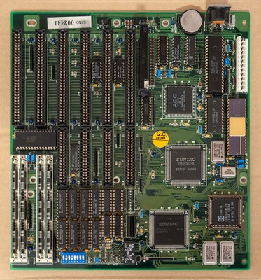

And here is the mod I'm aiming for, I will probably leave the SIPP slots untouched though, as it's more 286-like, on the other hand SIMMs are available easier (I didn't decided yet).
The attachment 65213788_10216891402070127_4957825503055577088_o.jpg is no longer available

No, you would run ISA at 6.25 MHz in that case (/4), just like you would for an 12.5 MHz 286 (/2).

Re SIPP: you should rather mod your SIMMs to have pins. Leave the board as is, it's more valuable than some SIMMs.
EDIT: love the Suntac board. I simply love baby AT boards.
The laziest way that leaves everything intact is to simply stick a pair of (desoldered, for example) SIMM slots into these SIPP sockets. Pairs of these tend to have the same distance as pairs of SIPP sockets. Though it doesn't feel a final solution it works for me quite well. And needs no alteration to the memory sticks, nor the board itself - only a donor board, of course. Or an other source of SIMM slots.
