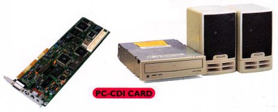

Looking for this card for almost decade now...
Haven't seen these links in your posts:
https://cdii.blogspot.com/2009/01/two-unknown … d-i-on.html?m=1
http://faberp.tripod.com/CD-IPCCARD.htm
I want this set sooooo much!
