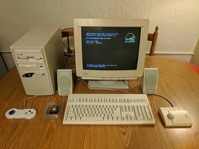

I have been on an ISA-compatible kick for a while now with some of my other builds (see signature) in order to maintain full DOS sound support, and somewhere along the way I decided that I should build a full ISA/VLB 486 system for my retro collection too. 😎
Specs:
Motherboard: MV35F ISA/VLB AT w/OPTi chipset, 30/72-pin SIMM support, 128MB RAM support, 512k Cache support and P24T support (was new-old-stock per the seller - it certainly looks like it too!)
L2 Cache: 256k (upgradable to 512k)
CPU 1: Intel Pentium Overdrive (P24T) @ 83Mhz (overclockable to 100Mhz stable)
CPU 2: Evergreen 586/AMD 5x86-133 @ 133Mhz
CPU 3: Intel 486 DX2/66 @ 66Mhz
Hard Drive: Seagate PATA 40GB (not even close to period correct 🤣 )
Disc Drive: Sony PATA CD-RW (also not even close to period correct 🤣 )
Floppy Drive A: Mitsumi 3.5"
Floppy Drive B: TEAC 5.25"
I/O Board: DTC 2280 Super I/O ISA
Video: Cirrus Logic GD5429 VLB 1MB (upgradeable to 2MB)
Audio: Yamaha OPL3-SAx ISA (YMF719E-S w/6.8nf Low-Pass Filter mod and Reversed-Wavetable fix) w/PC Speaker Passthrough Cable
Modem: Wisecom WS-3314JS3 56K ISA (somewhat period correct)
PSU: Unknown brand, AT, has AC passthrough port for monitor, seems solid - no leaking caps but needed to replace 80mm fan (was making a lot of noise on startup)
Case: Unknown brand, AT, has a 3-digit LCD screen with turbo button support (LCD screen's output changes in to 'SLO' when turbo is off)
Peripherals:
Monitor: HITACHI SuperScan Elite 611 (CM611U-511) 17" VGA Monitor w/.22mm Dot Pitch, 15Hz support, Sync-on-Green support and Geometry/Convergence menus
Speakers: Advent Desktop Speakers (w/low-level 3.5mm subwoofer output)
Keyboard: Keytronic AT Keyboard
Mouse: Logitech TrackMan (3-button) Serial
Gamepad: Gravis Gamepad (4-button)

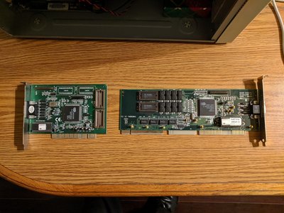

1. I found a damaged GD5430 PCI video card locally - it has a NASTY scratch through the back (you can almost see it through the PCI connector) and was unusable (not worth going through the trace repair process either) so I got it for free as a donor card for RAM. Unfortunately it did not have removable RAM (sockets were unpopulated) so I used my hot air gun to safely remove the soldered-down RAM modules from the GD5430 PCI, then I cleaned/prepped the pins and installed them in my GD5429 VLB (total of 2MB RAM now, performance is improved via interpolation feature on GD5428/5429/5430+ when 2MB is installed).

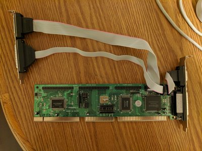

2. Installed a Promise VLB Super I/O card (PDC20630) for improved IDE speeds/etc... provides both VL/IDE and ISA/IDE connectors. 😀

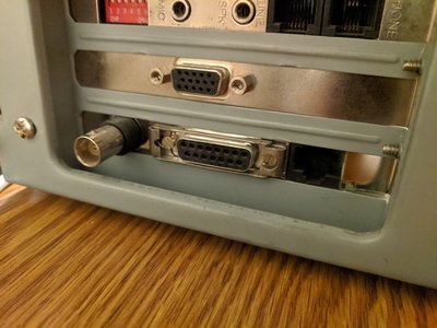

3. Installed a 3Com 3C509B ISA network card.

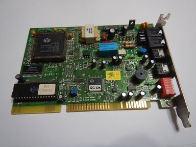

4. Installed a Wisecom WS-3314JS3 ISA 56K modem.
