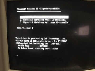

Hiya guys (first post here 😁)
I got a really nice packard bell 486 machine from some old lady yesterday.
http://pbclub.pwcsite.com/wiki/index.php/Spectria_9012
the HDD seems to be empty (but it shows up in the bios so it could possibly work?) so I tried to install win95 on it for dos games.
Welp the problem is that it doesn't want to install any drivers for the IDE panasonic cd rom drive. I've tried multiple windows 95 and 98 boot floppies, both original and third party and they all fail to find the cd drive. (check attached file)
The HDD is set as master and cd as slave. the jumpers are installed correctly.
I get a pci read configuration failure if I plug an analog cable between the cd drive and soundcard (which is some soundblaster 16 clone) when using the official windows 98 boot disk.
I've tried some backard bell boot disk images but the ones I've tried seem to print a single arrow character after the *starting windows 95* prompt is done and get stuck there, would be nice if someone had the proper images for the cd and floppy for this model?
EDIT: BTW the sound card has a "panasonic cd" connector. I don't sadly own a cable for it but could that help me in any way?

Reply 1 of 25, by derSammler

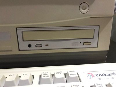

If it really is a 2x Panasonic drive, then the driver on those boot disks can't work, because they are for IDE cd-roms, which the Panasonic isn't.
Can you please post a picture of the cd-rom drive?
Reply 2 of 25, by AfterBurnerTeirusu
I'm pretty sure it's one of those. So I should be able to use it normally if I swapped it to a normal ide cd drive?
(I can open it up and take a photo of the stickers if you really want that)
Reply 3 of 25, by derSammler
The front of the drive isn't that interesting. 😉 Looks like a Matsushita CR-563, but can't really tell without seeing the label.

That system came with a cd drive! It's even the original one... He just can't use an ATAPI driver for it, since it's not connected to IDE.
Besides, it's completely moot if a cd drive is detected by the BIOS. This became standard when the feature to boot from cd was introduced. Up to that time, a cd drive was never detected by the BIOS. It doesn't have to, as it's not accessed through 80h anyway.
Reply 7 of 25, by AfterBurnerTeirusu
Here's a bunch of photos of the thing and it's drives. and yeah it seems to be a matsu. https://drive.google.com/drive/folders/1Pr_ij … LbT?usp=sharing

Reply 8 of 25, by Vynix
See the "CR-5xx" header on the sound card? That's where the CD drive should be connected, it's not IDE but rather a proprietary interface, first CD drives didn't have a standardized interface (to each manufacturer their own) except some which used ATA or SCSI.
