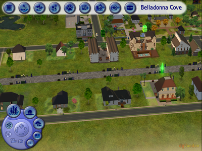

Reply 2 of 17, by V15UAL K3YS
Dege wrote:
Weird. It runs for me. It can be run in either forced windowed mode (like on the attached screenshot) or in fullscreen with opti […]
It can be run in either forced windowed mode (like on the attached screenshot) or in fullscreen with option GeneralExt\EnableGDIHooking enabled.
I can't see a single reason though why this game should be played through dgVoodoo.
Sims2 is completely software rendered. It only uses D3D9 to set the display mode (800x600) and do its vertex shading calculations through D3D9 in software, which literally means multiplying some vectors by a transformation matrix ( 😁 😁) for most cases. No GPU is involved at all.
So, the rendering technique of this game in itself is really weird. No dgVoodoo needed.
I'm sorry but I believe you are mistaken. The game will run in software rendering mode when using the internal 3d graphics card in the dgVooodoo 2 control panel because The Sims 2 doesn't detect that graphics card in the game's database. Therefore, the game assumes that the PC in question doesn't have a GPU and therefore forces the game to run in software rendering mode.
To prove this, I have uploaded a screenshot of me running the Sims 2 in Hardware rendering mode, using the ATI Radeon 8500 graphics card in dgVoodoo 2 (which is a GPU supported by the Sims 2) with all settings maxed out and in 800x600 resolution. With GDI Hooking enabled, I can also run this game at 1440p resolution effortlessly; the only problem that still remains is the graphics glitches that I have mentioned.
This is why I stated that I put the vendor id and device id in the dgVoodoo 2 config file. You have to do this when using the internal 3d graphics card in dgVoodoo 2 so that the game can recognize that there is a graphics card. Not doing this will cause the game to run only in software rendering mode.
This website: https://www.simsnetwork.com/tools/graphics-rules-maker
Has a program called "Graphics Rules Maker" and if you are running a modern system and are trying to play the Sims 2, you have to use this tool; there is a manual way to do it but basically, the program registers your current GPU into The Sims 2 system files so that the game properly detects your graphics card and runs it in hardware rendering mode. This goes back to why I decided to try to use dgVoodoo 2 to run the Sims 2, which in Hardware Rendering mode, has an infamous issue known as "pink flashing" where certain sims, houses, neighborhoods, etc, will flash pink because of shader file issues and GPU memory problems. It's in the game itself. I hope that helps to clarify some things. 😀
    1 MiB
    5105 views
    Hardware Rendering Screenshot

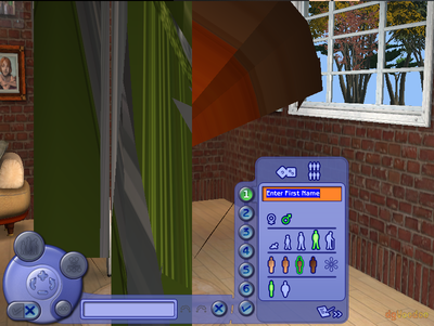

Reply 3 of 17, by V15UAL K3YS
UPDATE!
I have successfully managed to get farther with hardware rendering in the Sims 2, but it was only with dgVoodoo 2.6. The lack of HLSL support in 2.6.1 makes it impossible to properly run The Sims 2 with Hardware Rendering, so I had to revert back to 2.6 to properly run it.
In the dgVoodoo.conf file, you have to set ShaderCodeGenerating = 2 and use the d3dcomplier_43 and d3dcomplier_47 in the file where the Sims 2 executable is. Without using this the game has an issue with the DirectX 9 calls being made by dgVoodoo 2 itself and therefore crashes upon loading the neighborhood (the game apparently doesn't like the internal shader code generator). By using this though, I have successfully managed to load the neighborhood with the Internal 3d Virtual Card and thus have gotten farther.
Here is an image of me doing so, running Sims 2 in 1440p with all settings maxed out. Sims-2-1440p.png
However, this leads me to another issue. With ShaderCodeGenerating = 2 (using the internal shader code in any way makes the game unplayable) I can finally load a sim in Create A Sim without the game crashing. However, I do get serious graphical issues and this impairs my ability to play the game. I have uploaded an image of such graphical issues to further clarify. It doesn't look as extreme in the image as it is a still shot but the textures are constantly glitching and the areas where the glitched textures should be are completely invisible. However, I have not yet seen the red-flashing issue I have mentioned earlier and it only appears in the game's thumbnails.
    639.5 KiB
    4969 views
    Sims 2 Graphic Glitches
Reply 7 of 17, by Dege
Ok, I found a bug in the code generator that causes the crash and another causing the polygon corruption.
As for the flashing pink issue: when it occurs then the game draws with a vs/ps pair that transform a single position vector and emits a constant color.
I don't know what the appearance of the problem is relying on but it seems, as if some textures or other needed objects couldn't be loaded earlier and the renderer fell back to some very primitive shaders. Or sg like that. According to my observation the game eats up a lot of the address space with "too much" video memory available. And probably can't create all of its objects later.
Anyway, I think I managed to make it work: I selected the GF 5700 Ultra with 128MB. It's a card from 2004 with SM2.x support, contemporary of the game.
I played the game for some time (mainly the tutorial levels) with my limited knowledge and experience and it worked fine, no flashing red/pink polygons appeared (unlike with the internal card with much video memory).
But, it may appears after playing for, say, more than a half an hour, or with some very complex scene. I'm not sure. 😖
