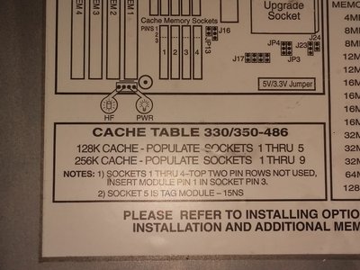

The more I learn about this, the more I want to rip my hair out. I installed all 4 cache chips correctly, set all the jumpers and even the BIOS settings correctly, and...
Nothing.
Guess what, folks? You now need a "Cache TAG module"! Something that I have never heard of once, nor have I heard anybody else discuss it before. Not LGR on his 486 build, not anybody else on any 486 builds at all, either.
Here's what the diagram on the inside of the case says:
1.45 MiB
1094 views
And yes, I avoided the top two rows of pins. The cache doesn't get hot or anything, it just does nothing.

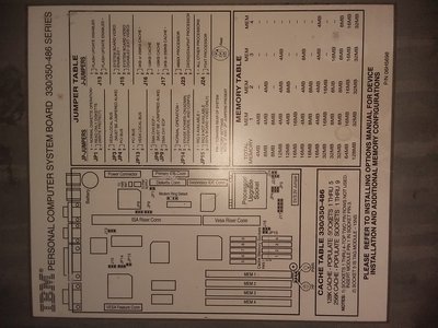

Reply 12 of 16, by athlon-power
flakes wrote:
If you can more of that photo would actually help us help you. all the information is probably on it.
Sorry it took me a bit, I've had work and it's taken me a little bit to get up to actually getting a picture of it. Here's the entire diagram:
1.6 MiB
1035 views
It's sideways, but it should be high-resolution enough to where you can see everything including the small text.

Reply 13 of 16, by flakes
Hi
You will definitely need Tag chip in Location 5. The jumpers may be set fine (0 or 128k) if you are only using 128K. If you were buying more to get a Tag ram, you may as well populate the 2nd row and set the jumpers according to the table for J16 and J17.

Reply 15 of 16, by meljor
it's the same chip, usually 9 identical chips work fine. And it's completely normal: just look at any picture of a 486 board with cache and you'll see 9 chips in most cases.

Oh. If I can find an identical chip, I'll use it. Though the chips I'm using are 20ns, and the diagram on the inside of the case says it uses a 15ns chip for the TAG module. Is that something I should worry about, or just one of those things where the manufacturer says you need a specific kind of item when other things will work just fine?
