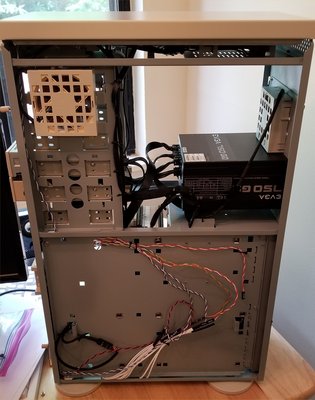

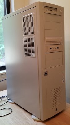

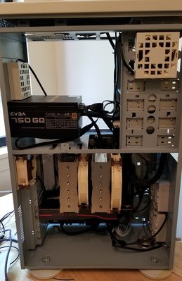

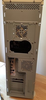

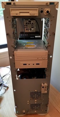

I just completed my first sleeper build.
Specs:
Addtronics 7890a Server Tower Case (circa 1999 or so).
EVGA 750 GQ Power Supply.
Asus Prime X470-Pro motherboard.
Ryzen 7 2700x 8-core CPU.
16GB G.Skill DDR4 Ram, 3000mhz.
500gb WD Black NVME drive.
Asus Radeon 5700 XT GPU.
Noctua NH-D15 CPU Cooler.
5 Noctua 80mm case fans.
1 Noctua 92mm case fan.
LG Blu-Ray Writer/Player.
Front panel USB 3.0.
Original 1.44mb Floppy drive connected with an internal USB 2.0 adapter.
I also added a white Monoprice mechanical keyboard (which is the most old-school looking modern keyboard I have ever seen) and a white Logitech G203 mouse to complete the retro look.
The chassis of the case was starting to rust, so I sanded it down and repainted it with Rustoleum winter gray spray paint. It's not an exact match to the original color, which was a bit lighter, but it's pretty close and looks "original" to me.
I also had to spray paint the face plate of the Blu-Ray player and the USB 3.0 Front Panel with Rustoleum smoky beige spray paint. I would say that this is the perfect spray paint for that old school beige look.
I did my best with cable management, but this case was not designed with cable management in mind. That being said, it is a very large case for its time and I was able to route most of the cables in a way that doesn't make the interior look too cluttered. There were some cables that just could not be managed too well though. I was also pleasantly surprised that the Noctua NH-D15 actually fits quite well. I think this is the largest air cooler out there and I have a good 1/2" to 1" of clearance from the side panel.
Overall, I am very pleased with the outcome. Other than the front USB 3.0, you would never know it's got modern hardware inside. I am also very happy that this amazing case gets to live on in a useful form.

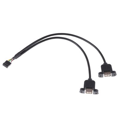

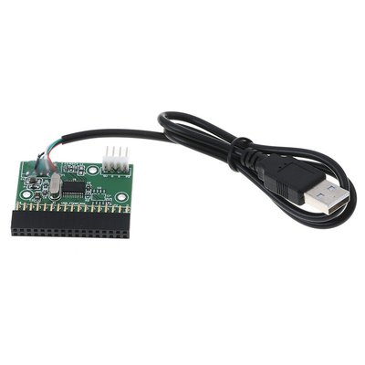

Hi,
Yep, how did you connect the floppy to the internal usb port?
byz
My system
Reply 7 of 12, by tegrady
I have a floppy to USB adapter I bought on eBay for about $11. The adapter connects to the back of the floppy drive and has a standard USB-A output/input. I then bought a USB 2.0 header to two internal female USB-A connections. Then you just connect the two and it just works.

Reply 8 of 12, by chinny22
Admittedly I hadn't put any research into this so didn't know the floppy to USB adapter even existed, but that's a great idea and connecting it to the USB headers is nice and tidy as well 😀

Reply 10 of 12, by SSTV2
Nice, that full-tower case looks very clean, is that a NOS? I think you should add some sort of suspension for the PSU, it probably wobbles when AC power cable gets inserted or case is moved. If I am ever going to build a sleeper, my case of choice would be that of IBM XT 😉
Reply 11 of 12, by tegrady
It's not NOS. I am the original owner for the last 20 years or so. It's been in storage for the last 12 years or so, and I take care of my stuff.
As for the power supply, there is a little shelf it is sitting on, you just can't see it. It's very secure.
