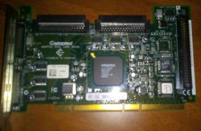

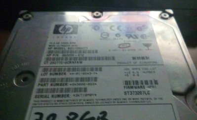

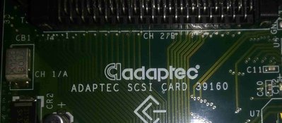

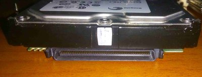

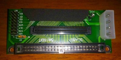

Hello,
i finally got some SCSI things, which i never had, because they was so expensive. I need help with their setup.
I have Adaptec 39160 PCI SCSI controller inside Super socket 7 machine - ALI V chipset. When i connector some old 500 MB SCSI disc to 50 pin connector at the end the cards its working fine. But have 73 GB more modern disk, which have other connector, because i cant get right cable for direct connection, so i bough on eBay some 50pin to this more modern cable adapters. I has some jumpers - see pictures, i not sure if understand them correctly but it seems that no jumpers at all means - SCSI 0 - i want to connect only 1 device.
When i connect them and boot, no device is found.
I have 3 x 73 GB disk some different vendors, but they are untested, i pure theory all could be dead, but when i boot, i hear booting sound and their leds are shinning. You can see error on one of the pictures. Some as adapter possible settings.
I dunno exist some direct cable for what i need?

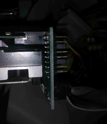

Reply 2 of 22, by SirNickity
The connector on that drive is called "SCA" -- it's meant to be used for hot-swap bays, and carries both data and power, but is otherwise essentially the same as a 68-pin SCSI connector. If this will be the only drive attached to your setup, ID 0 is fine, but you do need to make sure the chain is terminated at the drive end. It does not look like your adapter has a termination jumper, only one to provide active termination power. So you will need a cable with a terminator at the end, and your drive will need to be connected between that and the SCSI card.

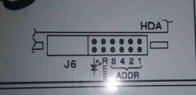

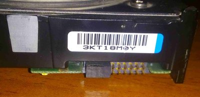

Reply 3 of 22, by ruthan
Thanks, i made some progress, one drive seems to be recognized (right size etc..), still with same cable / adapter. One show data error in inicialization table and one nothing.
All of these made some sort of jumper in the front, but all are set by same way.. I dunno what jumper means, its for drive ID?
With 500 MB HDD, i could read data from it in the Dos, with this working one, i dont see it, i dunno if disc is right, or just without partion, or need just drive even for DOS, im still working to make Windows 98 working, so i cant test it here, can see only safe mode where i can see controller and install drivers, but no disc - i have only one unsupported device here, i dunno if Win98 SCSI needs no safe mode boot or is problem elsewhere.

Reply 4 of 22, by luckybob
I really should do a video about setting up scsi.
are you trying to use the 50-pin and the sca drives on the same cable?
I'd like a diagram for what you are trying to do.

Reply 7 of 22, by Aragorn
Get yourself a 68pin u160 cable which has terminators built in.

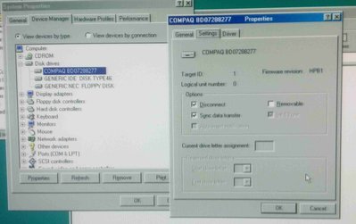

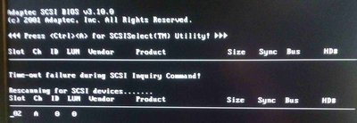

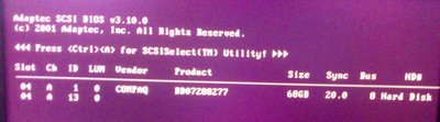

Reply 8 of 22, by ruthan
I made some progress. I with proper boot i can now see HDD between Disks in WIndows 98.. unknown device is probably something else, but i still cant use it.
When i start partition magic 8 (both DOS and Win 98, Dos versio see right hdd size, but its unable to complete operation, i dunno because im using drivers pack windows 98 boot cd where it is bundled) it crashes and fdisk not see SCSI disc (should he is it? Update sorryi forgot that i have now only 1 no SCSI disk, so it probably see it), so i need other way how to partition it, any tips?
My setup is simple:
- Controller - last 50 pin cable connector -> pin 50 cable with 2 connectors (im using last one)-> to adapter 50pin->-adapter hotswap connector>SCSI disk 73 GB Compaq something.
You can see controller is able to see the device, there could be newer firmware for controller, i havent yet time to check it (Update 3.10 seems to be last one).

Reply 9 of 22, by ruthan
Its up and running, i did it my way as usually, but regardless thanks all for help.
I booted with driverspack Windows 98 cd, besides its boot cd which i has only cd rom drivers which is primary reason why im using it, it has multiple partition tools, like gdisk, which i used, i discovered that some Linux and other primary partitions where here i deleted them.. and created one big fat32 parition with it, but it had probably only slow format options, so i after 1% i rebooted to Windows new disc was now visible and could do proper quick format.
Now i cursios if it would be visible without driver also under MS-DOS 7.1 as 500 MB or not, btw its need driver for DOS for performance as DMA for IDE disk or not?
Now i only need some good Windows 98 utility to change driver letters because i dont like new order of discs, i will go also some performance testing.
So not only Terminator way is possible but also Conan - the barbarian way works.. but ill be back:)

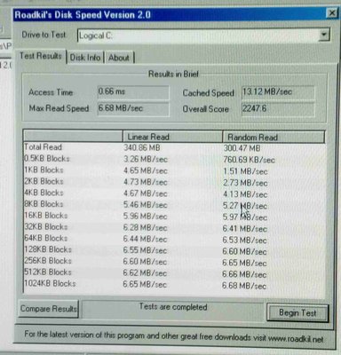

Reply 11 of 22, by ruthan
We will see is if it is true, or superstition.
Ok, what should be symptoms of not working terminator?
I actually have second cable type, i guess that strange T thing on the end is proper terminator, but it will use again that cheap eBay adapter to disc, which was primary thing i wanted to avoid.
I rebooted in Dos, drive is visible, regarding of Rayers rawspeed its capable as classic non Ultra DMA disc at 2.3 MB/s.
I did also some Win98 benchmarking, i have long time problem with Win98 HDD benchmarking some of them showing nonsenses (ATTO benchmark for example), i was pointed to Roadkill as something better.
There is SCSI drive capped to 6 MB/s i dunno what should be real speed, but my guest is et least 30 MB/s, but i tested my Sata SSD on IDE adapter and it is able to give me, also only 6.5 MB, so maybe both of these adapter such, or i need some VIA drivers, or its problem of vanilla Win98SE. I now that CPU (K6-2+ 500 MHz - 5x 100 - 512 MB RAM)is very slow, but i hope that can cap by such way disc traffic, i never bench marked such slimers machines in the past and dont really remember numbers from contemporary reviews.

I wonder that 50 pin controller connector should provide same speed as there 2 other? Is there some difference? I doing this stuff now only on third monitor, during something else, so i didnt have yet time to read the manual.
