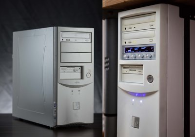

Hello everyone! I´m a completely new member to these forums and I figured I´d share my Retro PC project with you guys.
1.82 MiB
4738 views
So, this is my rig in its current state:
- case: Fujitsu ErgoPro eL
- mobo: Abit ST6
- CPU: Pentium III 800EB
- RAM: 512 Mb
- GPU: nVidia GeForce 2 GTS
- sound card: Sound Blaster Live! (CT4830)
- Some generic Lite-On DVD-ROM
- Some generic Lite-On DVD-burner
- Some generic floppy
- PSU: Corsair CX450M
- storage: IDE to SD adapter and 64 Gb SD-card
- cooling: 2 Noctua case fans + generic cpu fan
- speakers: Cambridge Soundworks 4.1
- Display: BenQ Q9T4 19 "

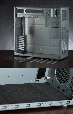

I started by dismantling the case to its bare bones, and while wiping it down, I though "Yeah, what the hell...", and hosed and scrubbed it thoroughly under a shower.
1.11 MiB
4739 views

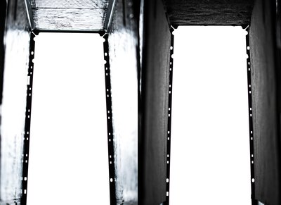

Another improvement for the case was sound proofing. There are a many things I feel nostalgic about but distracting noises are not part of those. I wanted my retro build to be quiet, so I also dampened the front panel of the case.I sanded every plastic part of the front panel, DVD-roms and floppy, and painted them bright white. Power and HD leds were changed to blue ones.

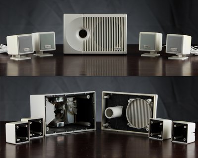

For speakers I found Cambridge Soundworks 4.1 speaker set for a reasonable price. However, the speaker cases vibrated terribly even at low volume levels, so I decided to soundproof them too. As a result, the sound quality improved noticeably bass sounding thighter and more accurate.

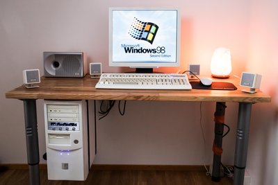

As much as I´d love a good CRT, they are simply way too impractical for me at the moment. So decided to get an older LCD, and I found a 19" BenQ Q9T4 for 20 €. I also sanded and painted the of the screen with the same shade of white as every other part, and changed the indicator led to a blue one. I did similar mods to my Keytronic MPR II keyboard.

2. At some point I will change my 4.1 speaker set to just a pair of speakers. As lovely as they sound, they just take way too much space and also create a nightmarish cable mess. With only two speakers, is it worth it to change my SB Live! CT4830 to SB Live! 5.1 SB0100?

Really like the speakers but get where your coming from with rear speakers and wires. You could just remove the 2 rears and still have a retro 2.1 setup.
