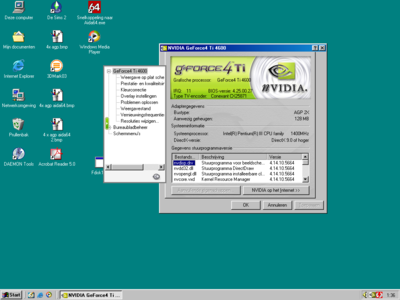

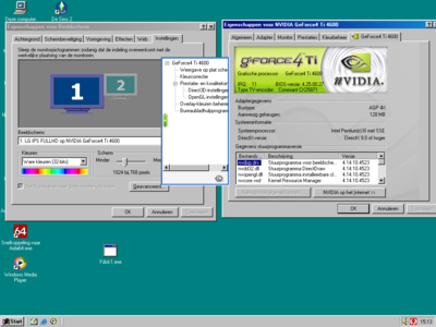

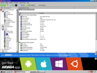

First post, by egbertjan

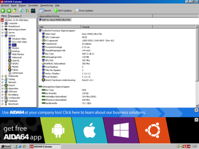

If I install a higher driver from Nvidia for my Geforce 4 ti 4600 on my Windows 98SE PC than version 45.23 then the PC switches back to 2xAGP. I have this driver version 4.38 from Via on it for the AGP port. Others via drivers unfortunately do not help to turn it into 4x agp again.
This is My Windows 98SE PC
Pentium 3 1400 mhz |
Video card: Geforce 4 ti 4600 128mb
Memory: 512 MB Memory
Motherboard: Shuttle AV18E2
SCSI adapter: Adaptec 29160N
HDD: ST373455LC
Sound card: Creative soundblaster live 1024
Who knows what I can do about this?
I need newer drivers from Nvidia for The Sims 2 and 3d mark 2003 to work properly.
See the ATTACHMENTS with driver versions 56.64 and 45.23

Reply 3 of 23, by egbertjan
I have tried different Via drivers, but nothing helped. I have the idea that the Nvidia drivers do something that makes them fall back on agp 2x

Reply 8 of 23, by egbertjan
The Serpent Rider wrote:
Once again - just use RivaTuner.
I tried the Rivatuner.
In rivatuner I can set the agp speed, but unfortunately I can only choose from 1x and 2x agp there.
Reply 9 of 23, by The Serpent Rider
You need to unclock those features first to enable 4x mode and FastWrites.

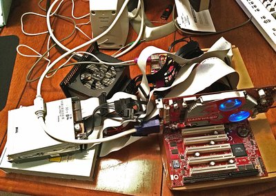

Color me curious. I'll go back and see if I missed that. Time to reinstall 98. I will admit it's been about a decade since I used it so this would be great if I can get 4x working on this board.
1.77 MiB
1837 views
I only bring out my best case for this kind of testing.

Reply 12 of 23, by liqmat
Yeah, think I'm SOL. Looks like that board is strictly an AGP 2x model even though the BIOS shows AGP 4x mode. Guessing they still manufacture them for industrial application, etc. for legacy systems.
Reply 13 of 23, by Bige4u
Thats unforunate... because the AGP slot is a universal 2x/4x varient, so it being stuck at 2x only is quit odd.

Reply 14 of 23, by The Serpent Rider
By default, Nvidia drivers will always limit early VIA chipsets to 2x without FastWrites. RivaTuner will unlock everything even on KX133.

Reply 18 of 23, by egbertjan
can you tell me how to unlock that in rivatuner?
Well, not surprising since they have cut other features from the board such as temp sensors, some dip switches and the game port from the original Gigabyte design. It is the VIA Apollo Pro 133 chipset which I now realize is strictly AGP 2x. According to Wikipedia the VIA Apollo Pro, Pro+ and Pro 133 were all limited to AGP 2x and it was only the Pro 133A & 133T that had 4x support in the Apollo line. Regardless, with the GeForce FX 5950 Ultra combined with that Chinesium board gets a score of 9056 in 3DMark01SE. So not too bad at 2x and the board is stable as a rock which surprised me. Plus the driver CD identifies the manufacturer as "Banana Digital". Who could hate a board with a name like that? 😎 Thanks for the help and sorry if I hijacked this thread a bit.
