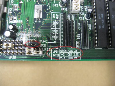

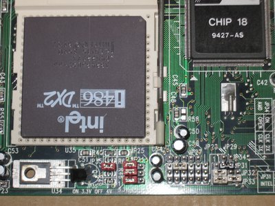

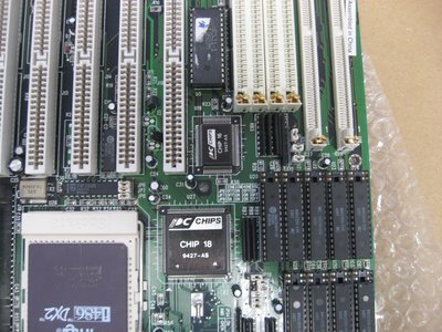

I'm having trouble setting up the jumpers of 486 motherboard.

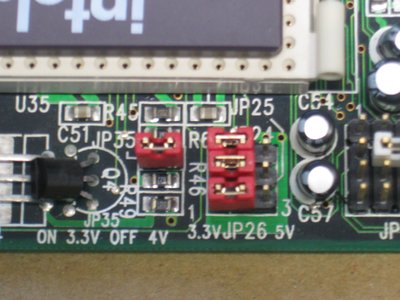

I have DC chips motherboard, but can't find any manual for it. The CPU I am installing is an Intel i486 DX2 A80486DX2-66. As I checked, this is a 5V CPU. I am afraid that I will damage the board or the CPU with wrong jumper settings. Are the jumpers set OK? How about those red jumpers (for voltage). Any help would be appreciated.

Reply 3 of 6, by Predator99
Think the reds also 5V for Intel DX2? But you wont damage anything when trying 3.3.
Also very low risk of damage when selecting wrong frequency for a short time...
I have the same:
search.php?keywords=PCCHIPS+CHIP+16+CHIP+18+9430-AS+9432-AS
As far as I remember it was running with the settings shown on the picture...

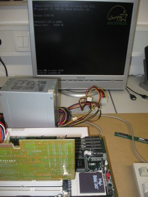

Reply 4 of 6, by Turbo ->
I've moved the red jumpers to 5V and it works. Thanks. Now I must find a nice heatsink.

Are there any other jumpers on the board I should be concerned about?
I dont know what do jumpers JP 6, JP7 and JP 8 mean? (see picture).
636.51 KiB
317 views
As I checked, this CPU has clock 2x, so I placed the jumper on JP 31 (2-3). I belive that is correct? (see picture)
517.45 KiB
317 views

Reply 5 of 6, by CuPid
Here is the doc you are looking for :
http://www.elhvb.com/mobokive/Archive/Oldman. … ips/jumpers.htm
It mentions the version w/ the black ISA slots, but the setting are the same on that model w/ white slots.
