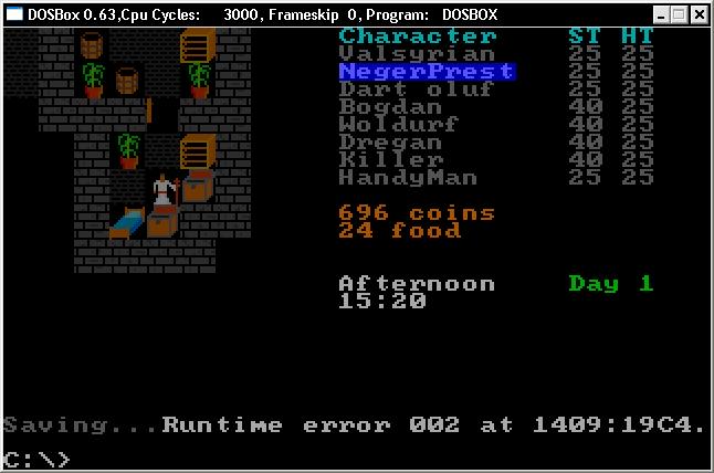

Reply 4 of 11, by Mr_Music
Hello!
I am experiencing the same problem.
When I try to save the program crashes and exits.
The error message I recieve is "Runtime error 002 at 1409:19C4." 😢
When I reload the game it has saved everything in the inventory and all character stats, but not my overland explorations, and what enemies I have defeated or doors I have opened.
This really is a shame because it is really a great game, despite the fact that the graphics weren't even that good when the game was released in 1994.
Is there someone who has been able to save a game properly and then reload it successfully?
Please reply if you did. Is there any settings I should be aware of?
I tried lowering the Cpu Cycles and trying different types of cpu to emulate, and I tried disabling the sound, but still no success. 🙁
Reply 5 of 11, by Qbix
Rank DOSBox Author
DOSBox Author
It means file not found. (error 2 that is)

Reply 8 of 11, by Qbix
Rank DOSBox Author
DOSBox Author
tried the game under the latest cvs.
Saving works there.

Reply 11 of 11, by Mr_Music
Thank you!!!
You wonderful wonderful person!
It works! It really works!
HAHAA!!
I'm so happy now, I´m gonna play all night!
Thank you so very very much!
The Last link to the CVS worked!
