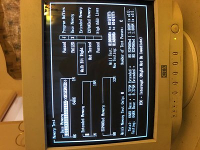

Reply 10 of 18, by devon
I appreciate the help! I got DOS 5.0 install and used winimage which created the floppy just fine. however the computer keeps crashing in dos and windows and playing games. keeps saying memory parity interrupt at 0713:018E

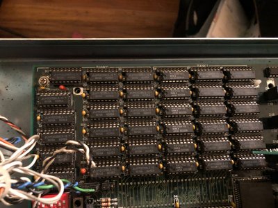

Reply 11 of 18, by Caluser2000
Grab CheckIt and test your memory. Sounds like one of the memory chips is faulty. 640k isn't very useful when using Windows either.

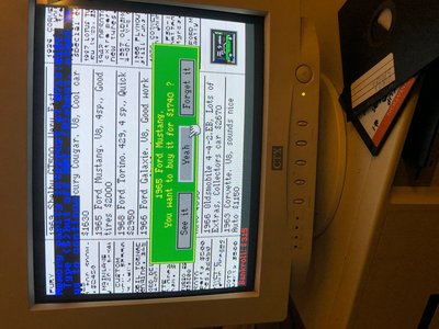

Reply 12 of 18, by devon
I tried checkit and it found some bad ram doing the continuous test. It made 1 clean pass before showing the failure. I also removed each ram chip and sprayed QD electronics cleaner in the sockets and reaseated them before running the checkit test. below are the attached pics of the RAM, the test and it crashed right before i could by the mustang in SR2.

Reply 13 of 18, by Jo22
Glad to hear the error is narrowed down, at least. The 286 was a very well designed and stable piece of silicon.

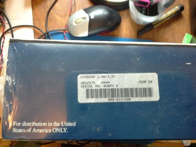

Reply 14 of 18, by Caluser2000
Some versions of Windows 3 were for US eyes only but strangely enough they made it out to the colonies. Hope I don't get arrested.
1.27 MiB
2497 views
Box is a bit battered but it's still sealed.

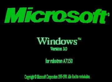

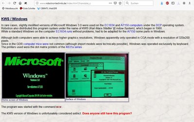

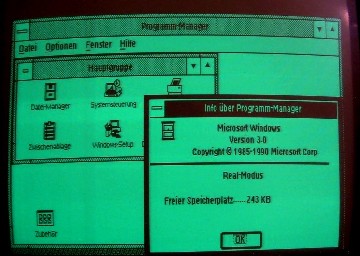

Reply 15 of 18, by Jo22
Caluser2000 wrote:
Some versions of Windows 3 were for US eyes only but strangely enough they made it out to the colonies. Hope I don't [..]
So it was YOU who smuggled them to evil East Germany, eh ? 🤣
(Just kiddding! ^^)
7.99 KiB
2470 views
29.82 KiB
2470 views
Source: http://www.robotrontechnik.de/index.htm?/html … re/isysteme.htm
PS. Englisch maschine translation is attached as screen shot below (-credis/lefts belong to the respect. persons-),
since the source page is coded in a typical bad German manner (it prohibits direct links, going back to main page).
In short, it's slightly paranoid, obedient and follows all regulations perfectly fine (lots of stuff in inpressum, email adress as pic-only etc). 😁
Edit; Not only that, but there seems to be an error, too:
"[..] Windows apparently only operated in CGA mode with a resolution of 320x200 pixels[..]"
I guess they did forget that the stock Win 3.0 CGA driver uses monochrome CGA mode in 640x200 pixel resolution.. 🙄
