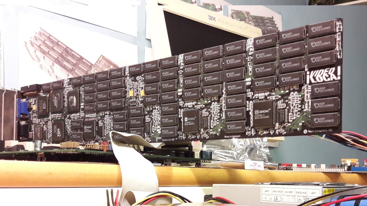

The Serpent Rider wrote:
Quantum3D Obsidian II takes only one PCI slot, huehuehue.

DNSDies wrote:
https://i.ytimg.com/vi/ZmCEXbspWuI/maxresdefault.jpg […]
