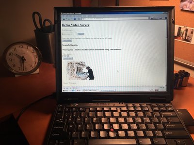

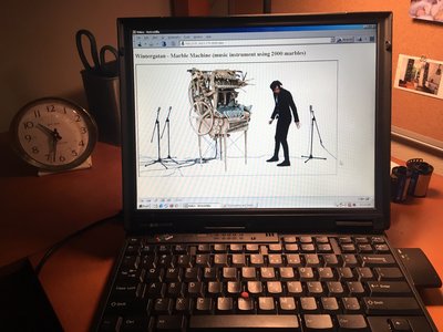

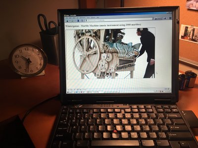

The title says it all -- this is a project to try to make YouTube work on retro computers.
It's geared towards 32-bit Windows on Pentium/MMX and up, PII or PIII recommended.
Basically, on your host server, it spawns a VLC process to transcode the YouTube video to a simple MPEG-1 format.
Right now it is very simple in that it only works for ONE client at a time. If you start a new video it destroys the old VLC process and starts a new one.
At some point I will change it so it will work for multiple clients at once, but it's only in the testing stages right now.
Clone the GitHub repo and try it out! https://github.com/keenmaster486/retro-video-server
Some screenshots:

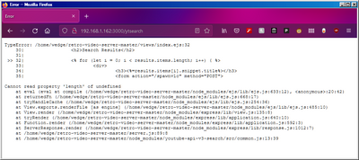

I just attempted to test this myself, and ran into this heap after a search. Given it's been 2 years, I'm not surprised something's gone wrong with the scripts. I presume you still use the Youtube Data API (and not the Youtube Live API).
With that said, the hard-coded script works fine, video transcoding and all. Great work!

Reply 10 of 13, by BitWrangler
Youtube changed something in the API early this year which broke youtube app on Gen 2 Apple TV and a load of older smart TVs. So might be the same thing.
Reply 11 of 13, by keenmaster486
Oh dang, it has been quite some time since I looked at this.
I should fire it up again and see if the structure of the data the YouTube API returns has changed. It probably has, that may be your issue. Try console logging the actual data returned to see if the "items" object still exists in there.

While I would do that, the terminal unfortunately gives... the exact same information as was sent to the browser. Unless there's a way to open server.js with debugging that I'm unaware of.
Also, now RetroZilla's having a fit over Winamp. I don't know why, but now I can't get it to open the stream in VLC within the browser.
