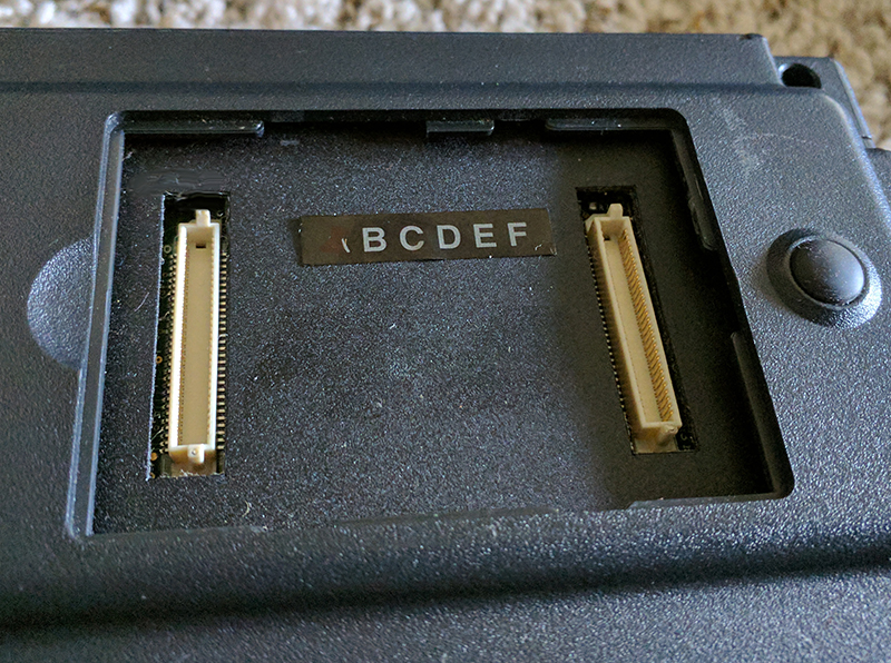

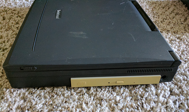

Changed CD-Rom on my mutant Twinhead P133 machine, so now it able to read any CD-RW 😎
Any advice what kind of memory can i put here?
looks very close to TI form factor, but different

Looks like the same type of double connector that Compaq was using a lot back then for their Laptops....
I know this is by no means helpful, just an observation
These are dual female slots though, iirc the Compaq modules were using male and female... And also were a little bigger.
Wouldnt be surprised if it's proprietary to this machine.

Found compatible module!
HP Omnibook 5700 5700CT 5700CTX 5500 5500CT 5000 2000 16MB RAM Memory Module

Nice 😁
These mid-90s laptops all seemed to have different non-standard modules - cool to know that Twinhead may have been the OEM of some of the Omnibook range
