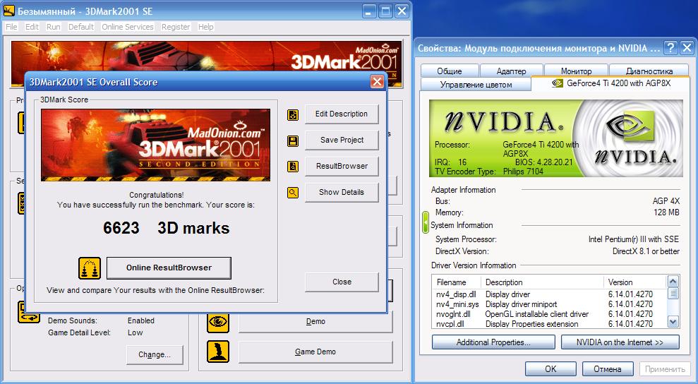

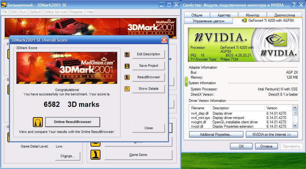

Hi.
GA-6VTXE-A, latest BIOS from their website
ASUS V9280 (AGP 8X)
BIOS: AGP Mode set to 4x
Win98/XP: In Adapter properties, it's 2x.
Quick googling shows that the issue might be related to Chipset. Some NVIDIA drivers allegedly see VIA chipsets and force the card to use AGP2X mode. It cannot be changed in RivaTuner.
Before I try with different board (TUSL2-C), anyone had similar issue? Should I try other Drivers? Which ones?
Or I won't notice speed difference at all, so I shouldn't worry about it?

The funniest thing (sorry for not mentioning before!) is -- VIA 4in1 driver version 4.43 (only version I could find) is what I installed initially, after installing Win98, among with other device drivers.
Maybe I installed them in wrong order? But everything seems to work fine.
Looks like I found the required checkbox -- it was located in very unusual (for me) location of the RivaTuner utility. What I initially thought to be the required setting was wrong parameter.
Now AGP shows 4x, as it should.
Thanks again!
Reply 5 of 24, by PARKE
Would you be so kind and run a couple of benchmarks (like for example 3Dmark2001) to see the difference between 2x and 4x ? Thanks in advance.
Reply 6 of 24, by lafoxxx
Not sure if the difference is statistically significant, but there's slight increase when using AGP4X mode.
Can perform 4 more runs if you want.
Reply 7 of 24, by PARKE
Thank you.
Repeating is not necessary, your outcome supports other observations.
I have just run a somewhat similar configuration:
XFX ti 4200 // ASUS P3V4X // 1GHz 133 PIII SECC // 3DMark2001 // 1024x768x32
and the outcome for AGP 4x (set in Bios) = 6698 versus AGP 2x = 6696
Your outcomes may be consistently a tiny bit higher in 4x mode but the difference is nothing to write home about even it is not based on statistical error.
