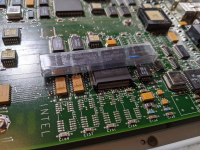

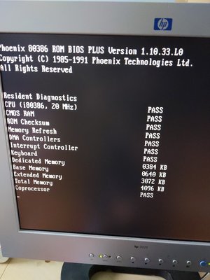

Intel 386.
It does not have turbo button so I wonder if there is a key combination to switch between slow and fast
Maybe some other information, like maximum HDD/RAM support etc.

PBA number indicates the 300-SX20 board.
Have a look at this service manual (search for Analyzer 300SX-20) for some basic info

Not sure how much, but it has cache.

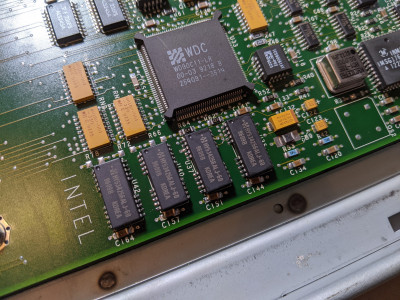

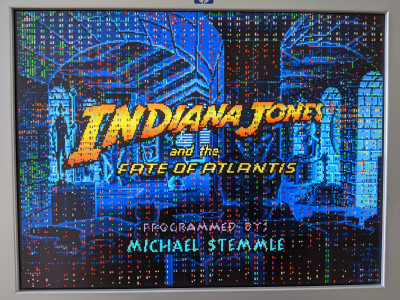

The board developed the broken image symptoms
Any idea what it could be? It works fine with external VGA card.
I already replaced the Video DRAM chips but it did not help
Reply 6 of 8, by pentiumspeed
since this is common video chip part you could buy wd video card with same part number from ebay and swap this one that you do have hot air station?
