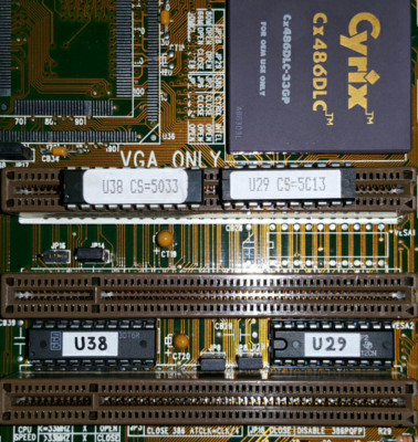

Mine has 2 missed chips in the middle of the board between the VLB brown slots 😢
Wouldn't be too concerned, I remembered the name now: AUVA CAM 33
Here's the exact page for your version:
http://www.uncreativelabs.de/th99/m/I-L/31375.htm
Look up U38 and U39:
VESA SLOT (S2 & S3) MASTER/SLAVE CONFIGURATION […]
Jumper / Master/Slave / Slave only
U29 (PAL socket) / Installed / N/A
U38 (PAL socket) / Installed / N/A
So missing the two PAL chips, your VESA slots 2 and 3 are slave-only. Not ideal, but perfectly usable. Whatever is stopping you booting, that's not it. Note all the other jumpers that need to be set for slave-only. If some of those are wrong it might explain a thing or two.

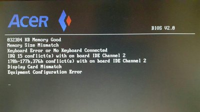

Reply 7 of 17, by dionb
Conflicts all over the place... that awful CMD IDE controller could be to blame. Disable if at all possible. But this mainly looks like default settings of the board are the problem, so sorting out the RTC would definitely be the next step.
Reply 10 of 17, by dionb
They're PALs. The "P" stands for Programmable. The chip alone won't help you without the code and getting that isn't straightforward. Read here:
PALs are programmable logic devices. You program them with very basic logic functions chains of AND, OR, XOR etc. etc. written i […]
PALs are programmable logic devices. You program them with very basic logic functions chains of AND, OR, XOR etc. etc. written in a high level language.
You will need the contents of the PAL chips. Without that you'll have to reverse engineer their function. You will probably never be able to read them to extract there program as they will have been programmed with the protection bit set (making them effectively write only).
You'll need something like PALASM (Assembler of code for PAL chips) to produce JDEC files and then a PAL programmer like a JTAG device depending on the type of PAL chip.
There is 99.99% NO chance to get the code from these PALs you'll have to either give up, reverse engineer them (not impossible due to their capacity and uber basic boolean functionality) or find the original creator. There is a very, very slim chance they are not protected.
But let's step back a bit: why are you so focused on enabling multiple VLB masters? (which is the only thing the PALs do). Before going down that rabbit hole, I'd thoroughly recommend getting the board working otherwise. Or have you already managed that?

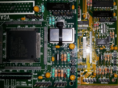

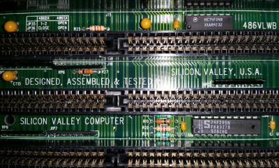

Reply 12 of 17, by RiP
I found another board ( 486VLWB ) which is very similar to the old one but it has crystal oscillator and different BIOS =/

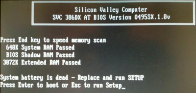

Reply 13 of 17, by dionb
RiP wrote on 2019-12-28, 16:09:
Yes, the board works fine now.
Do you have its updated BIOS?
Ah, sorry, missed this one.
Yes, it's linked here on Vogons:
Re: How about a MR-BIOS ROM file repository?
That leads to:
http://www.mediafire.com/file/icf36l68bw8kh7m … R-BIOS_v160.zip
RiP wrote on 2020-01-09, 20:18:
Not sure that '486VLBWB' is the name of the board. In any event, I can't make out chipset on the pics, so not much I can say here. Could you make a high-res pic of the whole board?
Reply 14 of 17, by RiP
Here you are: https://i.imgur.com/tClKs4k.jpg
dionb wrote on 2019-12-15, 14:00:
The original BIOSs on these boards were a pain, but there's a MR-BIOS for the 495SX that works on all of them and is vastly, vastly superior. In my case the original BIOS initialized POST fine, allowed entry into setup but hung when trying to actually boot from any drive. The MR-BIOS fixed that.
Do you mean booting from hard disk? Mine boot fine from floppy disk but haven't tried hard disk.
I could copy those two PAL chips too:
    265.03 KiB
    826 views
Reply 15 of 17, by dionb
RiP wrote on 2020-01-12, 14:16:
That is very similar, should work with same MR-BIOS.
Mine wouldn't boot from anything (HDD, FDD) with the old BIOS. Just hung there after POST. Tried multiple IDE, SCSI and floppy-only controllers. None made a bit of difference. Almost certainly a bad image.
That's very interesting. Didn't they have the security bit set?
