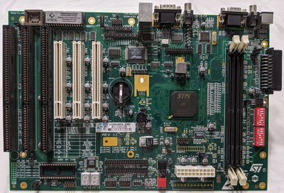

Finally am getting around to messing with this fancy eval board.
The SOC is a ST Microelectronics STPC Consumer-II x86 chip that is specced to run at up to 133Mhz.
Supposedly is is "5th gen x86" according to ST, but it doesn't look like it supports anything Pentium-wise although I did find reference to it supporting some of the extra stuff that the Cyrix 5x86 supports.
It supports up to 128MB SDRAM at 100Mhz. The SDRAM/onboard video clock can be configured from 45Mhz to 100Mhz within the BIOS although I am unsure if it actually adjusts the SDRAM clock or not. Testing will tell.
If using a single 128MB stick, it has to be double sided to work properly.
The RAM used for the video can be up to 4MB and the onboard video can also be disabled.
The mouting holes are standard ATX so no problems mounting it in a case which is very helpful.
Rear I/O has:
s-video, composite, and VGA out
composite video in
serial
PS/2 keyboard and mouse
The plug on the side of the board is SCART which I will never use.

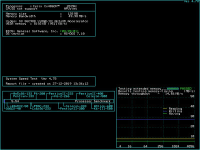

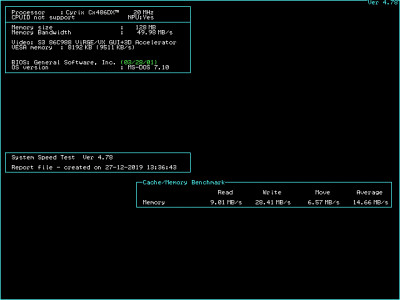

Here is where I will place some initial benchmarks:
This is the lowest speed I am seeing in Speedsys with documented settings.
60Mhz bus speed
60Mhz CPU
Disabled L1 cache (no L2 cache)
45Mhz RAM at 3-3-3
30Mhz PCI (which doesn't affect this test at all from what I can tell)
Note: Speedsys doesn't save the actual graph properly, and instead just does straight lines.
123.74 KiB
1216 views
50.28 KiB
1216 views
