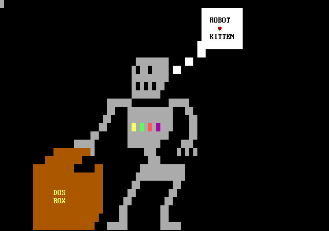

What you can draw in Pablo Draw will be displayed proper in DOSBox thus you can use the output to learn from it what is possible in DOSBox.
To handle *.BAT and/or re-edit *.ANS produced by Pablo Draw i recommend Notepad++ because it can handle ANSI files well and it's quite easy to write an escape sequence
because "CTRL+key" will result in ANSI codes, i.e. CTRL+[ will be parsed to (inverted) "ESC" as it is needed for escape sequences. Other special sequences you can copy paste from Pablo Draws output notepad++ will accept most of it. Sometimes it can lose the whole ANSI sequences in a file take care especially if you convert UTF to ANSI or vice versa.
I.e. UTF (inverted) "XDC" (which is 0xDC in hex) is in ANSI a "Ü" and will be displayed on the screen as "▄" graphical symbol. It gets lost if you convert the UTF file to ANSI and set or load the file later on as UTF, notepad++ will display then a question mark, once i lost a whole ANSI art file and all characters turned to "?" - take care, notepad++ depends on if the file is UTF or ANSI and if it's set to the wrong code the described error can happen since it's not clear by nature what i.e. "0xDC" is, it means in each code something else, notepad++ needs to know for which "language" (code) it is meant.
Of course it didn't matters if you edit an ANSI art file as UTF, i found out it's even safer as to convert it to ANSI because the inverted CTRL commands are clearer to differ from glyphs as i.e. a "Ü" is, on the other hand you will have a better overview over the graphic in your file using ANSI because the UTF CTRL sequences use two to three glyphs and this will scramble a graphic visually much for editing. All in all you will use the escape sequences different as Pablo Draw does, it is very conservative because it can't know for which purpose the file will be and escape seqences to change i.e. foreground colors will be used useless often (as it seems). I.e. Pablo Draw would use four escape sequences for this:

In fact with ANSI art and the proper programs one could create a sort of "robot ♥ kitten" batch proggie, request user input, randomize meaning and position of abstract glyphs (hide kitten) hover with the mouse over the "items" (abstract glyphs) and click on them to receive a stupid message "a half bitten piece of pizza" or in case "# found kitten! - # ♥ kitten!"
All you will need for this are Horst's small programs and a little creativity.
NSET i.e. can extract a given line and column in a text (or ANSI art) file and store it as global variable, it also can randomize the line to request, half of the job is already done.
RANDOM doesn't have to be explained, "roll a dice".
LINEX will extract a given line from a file or stdin and outputs to stdout.
Create a table with the abstract glyphs and request with NSET and the random function.
Randomize position of item, exclude used positions by storing progress to a global or a temp file
Create a table with the meanings, means stupid sentences "en masse" and use again NSET to extract random from the table.
Maybe you will need a different SET replacement which can add variables to existing stored globals or stash the stuff in temp files.
Splatter the result on the screen again by use of NSET or LINEX
