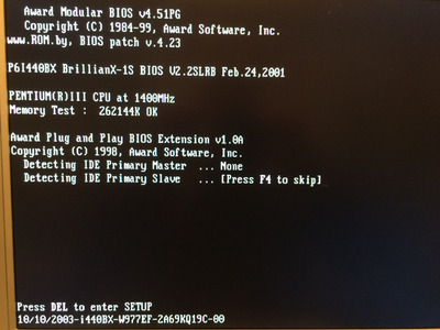

The truth is any old board witha a standard Award 4.51 BIOS will do. The BIOS might require modification, but the modified Korean Tualatin should work.
An good example is a recently purchased QDI Brillianx 1S board I bought locally a month or so ago:
912.28 KiB
1639 views
This BIOS was modified with the rom.by utility. I had to remove the BIOS recovery module from the file before the program could fit all the new microcodes in.
This works well for me, eventhough this board is nothing like a P3B-F or an Abit variant with voltage or divider adjustments.
Oddly enough, a Slot-1 coppermine I tested worked fine, but any socket coppermine I tried would not boot, even with various slotkets (including one with jumpered voltage adjustments - but with no integrated VRM like a Powerleap).
I settled with a Celeron 1400, because the Tualatin's 133MHZ 89MHZ AGP caused instability. Though I did not test with a PCI card to see if the 133mhz instability was the fault of the board or the fault of the videocard (GeForce FX5700LE).
Again, the Tualatin with a lin-lin adapter on a slotket (a very basic slotket - not the jumpered one) worked, but 370 coppermine chips didn't.

mockingbird wrote on 2020-01-17, 18:38:
The truth is any old board witha a standard Award 4.51 BIOS will do. The BIOS might require modification, but the modified Kore […]
Hi, sorry if I reply to an old thread, but since I also have an old QDI Brillianx 1S I wanted to know if you can share the modified bios for tualatin, thanks
