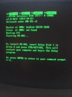

An embarrassingly long time ago, I scored an IBM PC-XT. It had 640k of RAM, a SCSI drive, and monochrome graphics when I bought it. I later installed a Hercules clone. The hard drive had been wiped, so I decided that this clean slate was the perfect opportunity to install a CF card adapter. I bought a lo-tech CF card adapter (I had to unplug the SCSI drive, because it was interfering with the CF adapter BIOS) and began attempting to install DOS. I tried using virtual machines, bootable USB tools (I think rufus is the one I used) and even plugging the card into a laptop and using disk images on USB drives to install DOS on the card. I got a brief taste of victory when I got the PC-XT to say "starting MS-DOS" , but it hung up indefinitely. I eventually admitted defeat and seceded that I would try using floppies, but I then discovered that the floppy drove is broken.
The PC is able to boot to BASIC and the CF card's bios seems to work fine and recognizes my card, so I doubt the problem is hardware related. Does anyone have any guesses what I am doing wrong?
Thank you for the help!
Reply 1 of 15, by derSammler
Which version of DOS did you try to install? On my IBM PC (5150), I had to use DOS 5.0. Older versions would simply not boot from flash memory and also froze the system.

Reply 3 of 15, by boxpressed
Did you use the fdisk /mbr command when initializing the CF card?
Reply 4 of 15, by Falcon_H
Thank you! That must be the problem! What commands do I need to do?

I can't quite remember, but I believe you do it in this order:
fdisk /mbr
fdisk
format c: /s
Here's another similar thread:
Can't Boot from Compact Flash

Thank you for the help, everyone! Today I was able to make another attempt at getting the CF card working. I booted a modern laptop from the CF card and added the master boot record. When I put the card in the PC, it actually worked! I get a message that says " to install MS-DOS, insert setup Disk 1 into drive A and press CTRL+ALT+DEl."
I have the three setup files, but I am unsure how to proceed from here.

The .IMA files are just archives. You can extract them with a modern PC and 7Zip, for example.
Maybe you can just put all the files into one directory on the CF card and run the setup from there?
