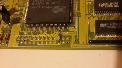

I bought a small bundle from a seller. There was an unimportant ISA VGA in the lot that I knew was repairably damaged (loose resistor needed resoldering). Apparently the seller decided to test the whole bunch out of goodwill. To my surprise they all work (screenshots and videos were sent to confirm), and a mystery CPU I got on a board turned out to be a Cx5x86-100 (Yay me?). But he went the extra mile and fixed the ISA VGA card as well.
With superglue.

He swears it works (and sent video to confirm) but I would of course like to remove the superglue and solder it back down properly.
How do I remove the cyanoacrylate without damaging the card?

Best way is hot air heat around 300C-350C will melt and vaporize that type, use flux as well. I had one happen to me at our cellphone repair and had to "melt that glue out" of the LCD screen's spring clip (mounted to the frame's but removed trying to scrape glue out by a tech with no success till I tried heat to help out,) for iphone. Don't ask me why, it was like that when came in for repair, some guy who tried to fix themselves botched it up.

I haven't had any good results heating superglue, plus the fumes that come off are incredibly harsh and you definitely need a face mask to prevent inhalation and any getting in your eyes. I have just mechanically displaced the glue when it gets in the way. It won't bond to the PCB and metal so it should come off pretty easily.

Acetone is typically what I go for to remove superglue residue from my items (and my fingers). I've never had it damage a surface, but I don't know what acetone, or the mixture of dissolved superglue and acetone would do to the surrounding components.

Acetone is a great and powerful solvent. So much so, I'd be afraid it would dissolve the solder resist

Acetone has no effect on almost any electronic part (only outer sleeves of e-caps and various other soft plastics) or PCBs, the soldermask is completely immune to it.

To effectively dissolve cyanoacrylate, you'd need some chlorinated hydrocarbon, and those are hard to come by nowadays. In most civilized countries, you need some kind of license to buy them, they're not very healthy. There are special cyanoacrylate solvents too, but got no idea how PCB laminate, solder mask, and electronic components react to them. Acetone can have some limited ability to dissolve hardened cyanoacrylate, but is far from effective.
I'd simply use a combination of heat to weaken the bond and mechanical removal in your case. Just take your time, and all should be fine.
IPA and other relatively polar solvents won't work at all.
Are you absolutely sure it's cyanoacrylate btw? It would really be an odd choice for that application. Epoxy would be far more likely in my opinion.

It is indeed cyanoacrylate. The seller is an ignorant (no offense) scrapper, he just used what was conveniently available.
Although ideally I would like to, I dont have to remove all the CA On the PCB (it is not polar and therefore not conductive right?); hopefully there isnt much on the underside so I can just mechanically clear it and apply some solder. The card works as is. Just CA isnt a great thing to fix cold solder joints 😁

Well, conductivity has nothing with polarity in that respect to do, rather with chemical bond types and how readily electrons can flow between nuclei, but no, hardened CA is not conductive 😀
Sounds like a sensible approach to the problem. Probably what I'd done too if removing all of it was too much of a hassle.
