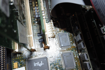

hello again. I have been trying to get a usb pci card working on my old gateway 2000 p5-75 for a few days. After tracking down a card that is supposed to work on windows 95(dlink DSB-500) and then tracking down the proper drivers....its still not working! Imagine that lmao. So the device manager says its installed and working correctly but when I plug anything into the ports nothing happends. I installed a service pack of sorts that is supposed to add usb support to win95 still nothing. Then i noticed that anything I plug into the usb port is not getting any power at all. The led on an optical mouse would not come one and the led light on my usb drive was not lit. I took a look at the motherboard and noticed that next the the pci ports is a aux power plug. It looks like an AT power plug . I do not have that plug on my psu but im wondering if it needs external power. Here is a picture of the plug. Anyone have any ideas ? Do i need to supply power to this aux plug?

That's a standard footprint part, so make no assumptions about what the pinout is supposed to be. That said, the pictures I found when Googling that part number did not have any such plug on the PCB. Do you have a picture?
Note also, in case you weren't already warned, Windows 95's support for USB is trivial at best. Don't count on using it for storage devices -- nobody writing code for Windows 95 had ever seen a thumb drive before.

Oh, my mistake. I thought you had said the plug was on the PCI card, not on the motherboard next to the PCI slot. That's different.
Still, be careful. The original AT and all its clones used two of those connectors, side-by-side. ATX replaced it with the 20-pin Molex Mini-Fit Jr plug. But, later, mostly for socket 423 Pentium 4s and similar era AMD CPUs, they brought back that same exact plug for additional power to the CPU -- with a different pinout, of course. It got retired pretty quickly in favor of the ATX 12V connector -- the 4-pin Molex Mini-Fit Jr plug, and then the 24-pin ATX connector, and then a 6-pin 12V connector.... Basically, the industry can't figure out how much voltage and current is enough for a CPU's main power rail, so they keep slapping new plugs all over the place -- many of which fit in the holes that other standards used. Fun! Next, let's talk about PC video connector standards....
Back on topic though... That connector could conceivably power the PCI slots (although I haven't ever seen that before -- but if it's a proprietary board, anything is possible. You have another card in the slot next to it. Does that work?
There are a few things you could do to figure this out definitively, rather than expecting some yahoos on the Internet to have the right answer:
1) Turn off the PC and unplug the PSU from the motherboard.
2) Use a multimeter in continuity mode. Stick one end on a known ground point, like one of the metal rings around the motherboard screw holes. Probe the pins on that mystery connector and see which ones beep. (I would be shocked if none are tied to a common ground. You will be shocked if you have built up a static charge.)
3) Find which pins on the main motherboard power connector are +12, +5, +3.3. See if that mystery connector is tied to any of those rails. It might be, in which case it just helps deliver more current, and can be left unplugged if you're not stressing the capabilities of the main power connector.
4) If the above test fails (no continuity to the + rails), get a pinout map of the ISA and/or PCI slots and see if their +12, +5, +3.3 pins connect to the mystery connector, or if they are in fact tied to the main power connector.
5) If you're brave, reconnect everything and power it up. Carefully probe the ISA and/or PCI slot power pins in Volts mode to make sure they're getting power.
6) Carefully probe the USB port to see if you get +5V on the connector. If not, try to trace the circuit from the USB jack back through the PCB. It'll probably connect to a polyfuse (it's often a little flat surface-mount chip, commonly green or blue) which could have burnt out. Maybe that's why they sold the card? Check the voltage on each side of it.

Thanks. ill give it a try.
