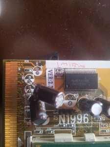

yes that post is mine. ive replace all 1000mf caps and the 2 mosfets on the motherboard. now the board working wonderfull. ive aquire the slocket from ebay for 5 euros. but just now see something missing on the slocket i will post a photo. ive replace the electrolitic caps on the slocket because my slot has long tight brackets and damage the original ones and thats why i solder them like that. i can repair the bent smd cap but dont know the capacitance to replace the missing one

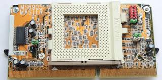

Is this the MS-6905 Master? If so I have one lying around somewhere, I'll try and look at what is in that position in mine.
Edit:
Not even sure there should be something there...

yeah we have exacly same slocket. under the black ic there are 2 smds the one in the outer side is the capacitor i miss
Reply 7 of 9, by PC Hoarder Patrol
Just checked one of my v2.3 and there's definitely an smd where you're missing it!

yeah the dried flux when i see it through magnifier glass tell as much. can anyone measure it? so i can buy a replacement
Reply 9 of 9, by truemaster
ive done some search the missing capacitor is conected to ic tvc16222 this ic manage the voltage. but cant find diagrams. my only hope is if someone can measure the capacitance of this capacitor
