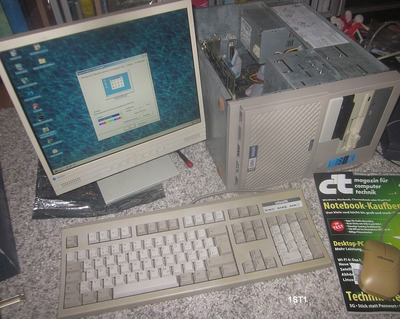

SNX 140/s with Windows 2000 on Weitek P9100 VGA card

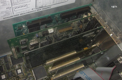

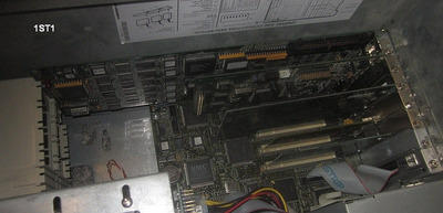

Adaptec 1740 (top) and 1740 Early Revision (bottom)
78.96 KiB
1403 views

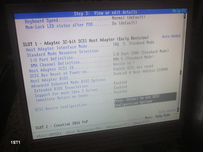

1740 installed
92.02 KiB
1403 views
1740 EISA setup

2740 installed
59.42 KiB
1401 views

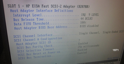

2740 EISA setup
108.13 KiB
1401 views
Windows 2000 Device Manager, no EISA SCSI card detected
As you can see, EISA setup detects them, but they are not visible in Windows 2000 device manager.
Any idea?
